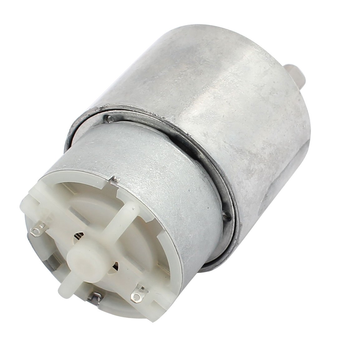

Because your Q2 has a lot to do with Q1, it is important to determine exactly the motor you have. Do you have this motor as per the Instructable? https://www.amazon.com/gp/product/B006W2HLSY?psc=1&redirect=true&ref_=oh_aui_detailpage_o03_s01
If so, look carefully at their picture:
Those two prongs are where you will connect the +12 and GND. Look carefully and you will see the + mark on one of the prongs. That is where the connection to +12V is made.
Note also that in the comments, some people reported that the RPM of what they were sent was much higher than the advertised RPM. Just be aware of that.
If you have a different motor, then you have to find out the characteristics of the motor that you have first. If you have the one pictured, then some of the specifications are in the advert - including the .07A rating which is a very important one.

Yep, that is the motor that I have purchased. I didn't know that about the prongs +/-, good to know. I think the tutorial expects you to have a decent background knowledge of electronics which I'm now trying to get my head around.
