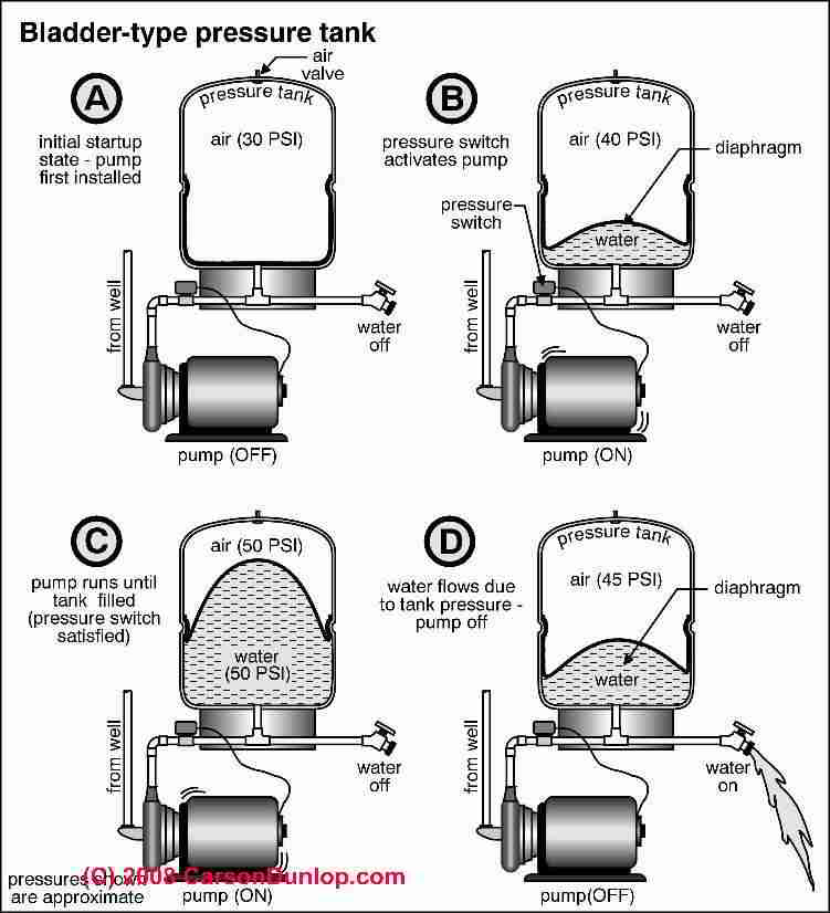

I have kinda been thinking of capacitors like water bladder tanks
Where when inserted inline on a circuit it will draw power till it is full, then deliver only what it needs to in order to satisfy the maximum required power that may be momentarily higher than the "pump" or in this case incoming power is supplying. In that case, the amount of water (or to my understanding Farad) the tank can hold is independent of the PSI (or in this case voltage), it has a fixed size, and will hold what it will hold, but to get a higher voltage, you need to apply that extra energy to get it in.
