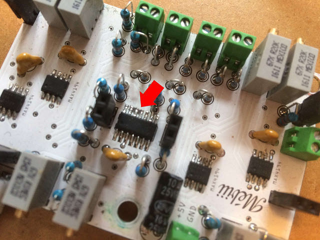

The PCB is not homemade. It's from Fritzing and I've just checked: it's supposed to have plated-through holes. Usually everything's fine but with this specific PCB I have had a strange issue that might be the cause of this : at some points, when soldering, a black liquid appeared. What could be wrong?

You could add some extra soldering flux under the component before soldering. This would help the solder flow to where it needs to be. The flux in the core of your solder doesn't seem to be enough to "wet" the trace under the component, the extra flux would/should change that. Also be sure to abrasively clean the copper of the trace right before soldering, any tarnishing of the copper reduces the ability of the solder flowing.

You are applying too much solder/heat as I can clearly see that the solder is covering the pad on the component side too.. It does not need to be like that.. Its excessive.. (but not really an issue)
What solder are you using also.. Sounds like you may have some "old" solder or incorrect solder for the application..
black liquid could either be excessive/burnt flux or burnt adhesive from the core material/adhesive used in the production of the board..

Here's a picture. You can see this in several places near IC legs, but it's most visible under the red arrow.
You need a 50W temp controlled station with broad tip.
Then you can solder SOIC much better.
Even the most careful point soldering will never give same appearance for all pins.
The heat delivery is much better as well.
With lighter gasoline, you can get rid of the residues. Be careful though not to wash it inside terminals or trimmers etc.

I guess the temp is too low or the wattage too small.
330 to 350C are good for soldering.
If you only have small joints 330C or 315C will prolong the life of the plated tip, 350C already will cause a shorter service life.
Factory plated PCBs are all tin plated.
Only thing where I really need flux is TQFP ICs. Depends on the quality of the soldering wire of course, some kinds are pretty bad. Not only the flux is weak. There are some kinds which require cooling with no movement for several seconds. While others become plastic at much higher temp which allows some movement.

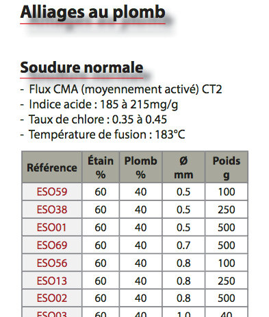

I am using a solder with 60% Sn/40% Pb (no Ag) - size 0.8mm with flux, ref. ES013 from French brand B.M.J.
Translation from the catalogue:
Lead alloys
Regular solder
- CT2 CMA (midly activated) flux
- acic index: 185 to 215mg/g
- level of chlorine:0.35 to 0.45
- meltdown temperature: 183°C
