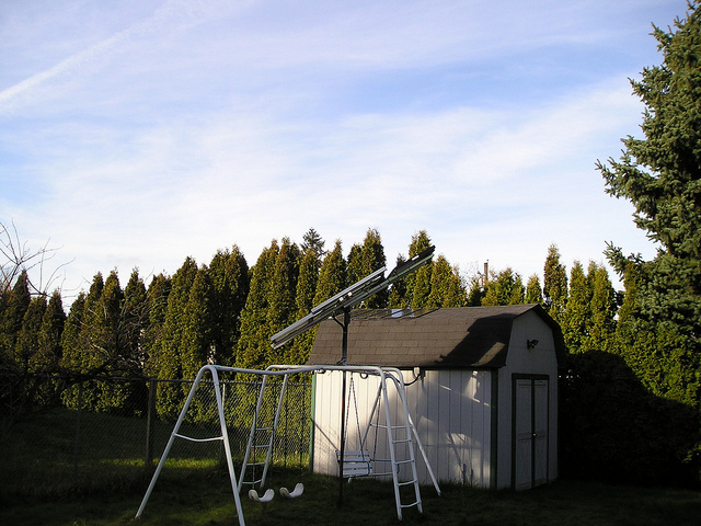

With the cost of panels so low today it's more economical to just use fixed panels on the ground.

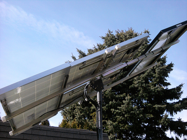

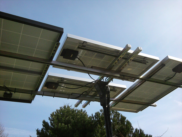

Here is my manual position panel mount.
A one meter KU band dish mount mod. Sched 80 high pressure pipe.
I rarely change the tilt angle because it's a pain and doesn't really change power output much but do rotate it maybe a few times daily in summer to optimize morning and evening power.

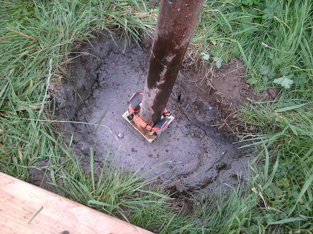

Buried rotation concrete anchor with brass load bearing bushing. You can spin the array with one hand easily.
Used the old kids play-set for bracing.:eek:
