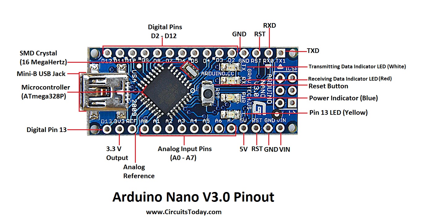

Here is a partial solution using ArduBlock with Arduino. Used Arduino Nano board,
pretty cheap.
The right window you drag and drop programming visual blocks, to create functionality,
then hit upload and it generates the Arduino code in left hand window, and then programs
part on board.
Lots of fun. Now a way to see what C code looks like. The Arduino code is "mostly" C.
So you can program visually, and observing generated C in left hand window.
Note you would add to this code for an LCD and a couple of buttons so you can set time for each
battery. Or do a terminal session with a PC or UART to PC and some Python code
to yield a GUI for setting battery parameters. Or use an ESP8266 and do a HTML
net session with Arduino and PC.
Note Nano board operated by xtal, so timing very accurate, << 1%.
Regards, Dana.
