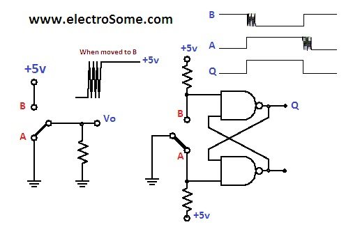

Setup the first stage of the circuit by eetech00. Despite trying three different make of the 4017 decade counter (CD4017B, HCF4017B, & M74HC4017B) and could not get one to work. Tried multiple chips of each make, kept the diode, removed the diode, kept the cap, removed the cap, tried both 5V & 12V, moved the chip on the breadboard, Rewired...etc.
crutschow
Joined Mar 14, 2008
38,952
I see several problems:
Each LED need a resistor in series.
The clock has nothing to pull the signal to ground (it won't go there by itself). Add a 10kΩ resistor from the clock input to ground. A floating CMOS will float to an undefined state.
An open circuit CMOS input is not logic zero.
Never-ever let a CMOS input float. :eek:
If PB is a mechanical switch the contacts will bounce when energized, generating multiple clock pulses with each closing. You need to add a debounce circuit (Google it).
D1 serves no purpose and allows the Reset input to float to an undefined logic state. Remove it and connect output 3 directly to RESET.
danadak
Joined Mar 10, 2018
4,057
You are trying to clock the clock with a mechanical push button. Thats
not good as they bounce due to inertia generating many clocks on a single
press.
You have to debounce the button. Many ways to do this, also using code in
UP.
Regards, Dana.

Built the circuit below. Upon power-up, Pin 3(4017) lights up. Pressing the PB turns Pin 2 high, and with an additional press Pin 4 goes high. As one LED turns on, the other two LED's are off. However, this is consistent only when I press deliberately. If I press lightly or quickly the LED sequencing order can fail.
Note: R1 & R4 are 8.2k, not 8.2 Ohms
I have read that all inverters are not created equal for TTL circuits. These are the Inverters I have on hand:
- HCF4069UBEY(Hex Inverter)
- MC14584BCP(Hex Schmitt Trigger)
- MC74HC04(Hex Inverter High-Performance Silicon-Gate CMOS)
- CD4050BCN(Hex Non-Inverting Buffer)
- CD4010(Hex Buffers (Non-Inverting)
Further observations:
While waiting for replies, I did some more reading. I noticed that the 1uF capacitor I was using was polarized. I think it was a Tantalum cap. I switched it out for a .33uF ceramic cap and I could not replicate the bouncing effects. But!... I also tried the switch with no cap in the circuit and also had no fails. Then I reinserted the polarized cap and could not reproduce the fails either! Perplexed. Not sure if my values for resistors & cap are in the right ballpark, so insight on this would be helpful. From readings, I learned that the diode in the debouncing circuit helps speed up the switching. Also, the inverter should be taking care or the RC ramping characteristics.
Q: Any advantage to debouncing from low side rather than high side? I can't see any, other than what may be simpler for the system/circuit.
