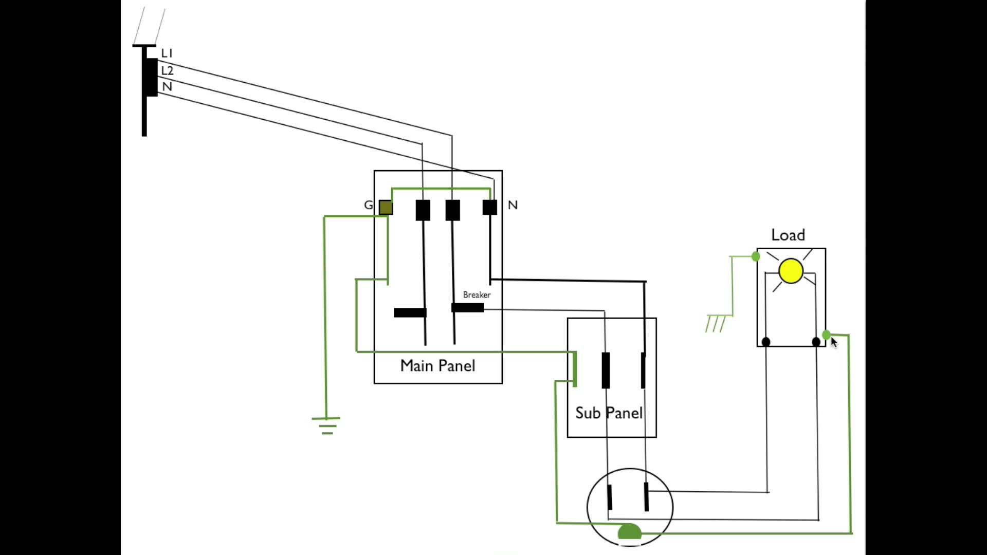

use a transformer to convert 220 to 110v and use the earth wire to the casing for safety.
You don't need a neutral.
Under N.A. code you can set up a new neutral see post#5,. one secondary terminal is connected to the earth ground conductor immediately at the Tfmr terminal.
IIRC it is also allowed in UK.
The two conductors are then taken from this point, Earth and Neutral.

The transformer makes the neutral. Ground is for the casing like you just said. They are not the same until they are bonded together. Ground is what you stand on. Neutral is made by a transformer. That's my understanding. I know how it is done.
Not sure what you mean by "The Transformer makes the neutral"?
In the case of galvanic isolation caused by a transformer the neutral is lost, therefore any secondary connection can be used to bond to earth ground in order to create a new neutral conductor.

Actually Neutral is defined at the power pole, it is the wire from the transformer that is connected to ground. After that they are not connected again. It is so appliances can blow fuses / breakers if they short out hot to ground (the metal case).
The USA uses a 2 (split) phase 240VAC system, and neutral is a center tap on the transformer (in addition to being connected to ground). In a 240 VAC outlet neither hot wire is neutral, and there will be 120VAC between each hot wire and neutral, which may or may not be present depending on the wiring and connector..
See post #45 also NFPA79, NEC
Note 480/120v control transformer in attached pdf.
Neutral & Earth are initially connected in the service panel.

I haven't followed this thread in fullness, so I am not familiar with the back ground info on this thread. Many localities have the transformer on a power pole, and that is where the separation is done. It is by far the most standard practice. You can see the wire running down the telephone pole. Meanwhile there are two hot wires, neutral , and ground wires running to the home.
In large buildings, where the transformers are much more local I suspect things are done differently.
My house has underground wiring to the house, with the transformer sitting in a box next to the curb. It is done there with that setup.

Take a look inside your service panel, I would be very surprised if the earth and neutral were not connected there.
I also have a transformer sitting on the edge of my lot, there is a ground at that point also.
The discussion on the subject of a local 120v outlet concerns a galvanically isolated transformer and the re-establishment of neutral.

I have a 220V water pump located approximately 150 feet from the house. The exterior grade direct bury romex type feed has a black, white, and bare copper. I would like to create a 110V outlet in the pump house.
Can I use the bare copper wire as my neutral going back to my service panel and create a new ground by clamping off the well casing, or is my only legitimate option to run new four wire romex back to the house?
I doubt if code will allow it. Also, a "double" link between neutral and ground could boost mains usage, with circulating currents, in a worse case situation.
The only safe way to use the cable you have, is a 220V to 120V transformer (you did not mention motor power requirement for the pump!?)
Or to run a new cable with 4 cores, which should have been done originally anyway......that is basically the problem.....a cheap, previous installation........

that all seems to depend on where the control box for that pump is located. i assume the pump is a submersible 1/2 or 3/4 horse power pump or etc etc. if it is in the pump house then a transformer would be the right thing to do. if the control box is located in the house the those 3 wires are NOT the 220 line. they are 220 with a start winding wire.
