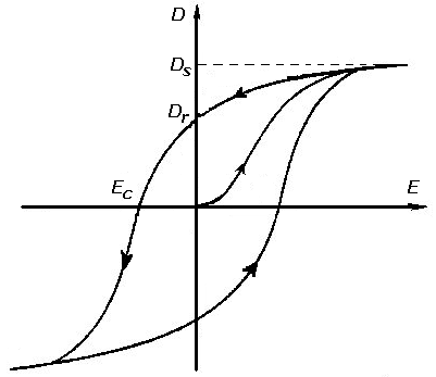

Is there a way to achieve reverse hysterisis?
Normally, schmitt hysterisis up-threshold is higher than its down threshold .
I want the reverse-- going up trip at a lower V . And Going down trip at a higher V .
To state it another way: If we think of a Schmitt as being "less sensitive" than a normal gate, I want a gate that's more sensitive .
First guess, a window comparator
Seems that would work as I described .
Wondering if my need could be achieved by tweaking 1 or more Schmitts.

johnyradio
Joined Oct 26, 2012
615

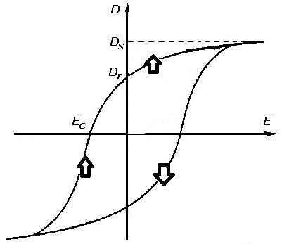

normal schmitt output. Trip-points circled:
my desired output:
my desired behavior (opposite of normal hysteresis):

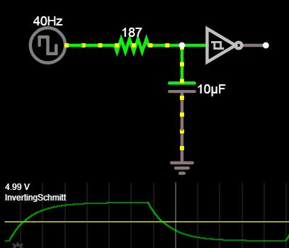

Generate the square how? i'm generating the triangle with a schmitt oscillator. I would like a square which is shifted from the triangle. Reverse hysteresis is one theoretical way.
i solved this another way, as shown here. Instead of driving the 2nd schmitt off the 1st schmitt's triangle, i'm instead taking the square from the 1st schmitt, shifting it with an RC, and then driving the 2nd schmitt with that filtered wave:
https://tinyurl.com/y9cv6mqh
Works as expected in LTspice by @crutschow (since my falstad seems to have a bug in the schmitt thresholds):
https://forum.allaboutcircuits.com/threads/time-shifted-square-using-schmitt.152749/#post-1311348
