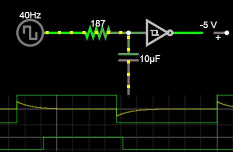

My intention is using the RC filter to apply a little delay to the input, so that the Schmitt output is a square wave that's time-shifted from the first square wave.
Desired output:
Here's my attempt. But the output of the Schmitt is curvy, not square. Why?
http://tinyurl.com/ydx8bhmk

I think you have a too large capacitor and need another Schmitt.
It appears from my new screenshot below, that my cap is a good value.
If you want to get the same phase then you need to in series with a Schmitt Inverter at the output.
if i want what same phase? Do what in series? i'm trying to delay phase.
That looks like the input to the gate, not the output.
indeed, not sure why that happened. Seems it wants an "voltmeter output" after the schmitt. This works:
(falstadt)
http://tinyurl.com/y9cv6mqh
It's close to what i want, but why is the rising delay different than the falling delay?
Do i need a bias resistor? On the input to the schmitt? Should it's value be related to the RC resistor-value?
Thx
Don't know.
Perhaps it's the value for the Schmitt trigger threshold in that model.
Below is the LTspice simulation, which has the same delay for both the rising and falling signal, which should be close to the real circuit.

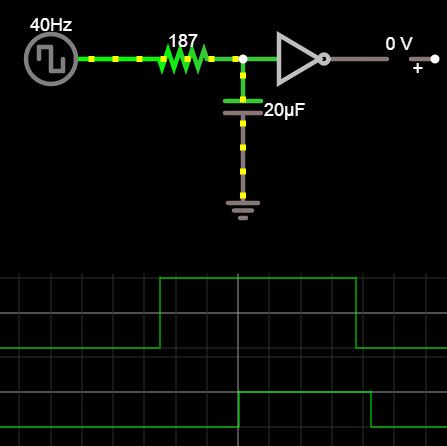

Can you plz try plugging in 20 uF for the cap? I'm getting radically different delays, and i think it's due to hysteresis. I think it would require a gate without hysteresis to get identical delays.
Update:
Shucks, i'm getting different delay times with a regular inverter too. I think bias is needed, or maybe a series cap someplace.

Here you go.
Note that 187Ω is too low a load resistance for most signal sources.
Better go use a higher value, such as 1.87kΩ with a 2μF cap, which gives you the same time-constant and signal delay.

Is the input square wave actually AC (-5 to +5 V) at #10? That will account for different delays. Crutschow's input is from 0 to +5 V.
Great point! But I'm doing unipolar.
I believe I the apparent time difference wasn't. The issue was: I needed to wait for the cap to settle to equilibrium. Then I get equal delay :)
Thx!

I'm quite baffled by both #10 and #5. In both cases the input waveform apparently has twice the amplitude of the output (and appears to be centred around zero - the yellow trace at #5 has the same baseline and is presumably the current through the resistor and would actually be AC even if the input were unipolar) and the outputs are not inverted as they should be.
