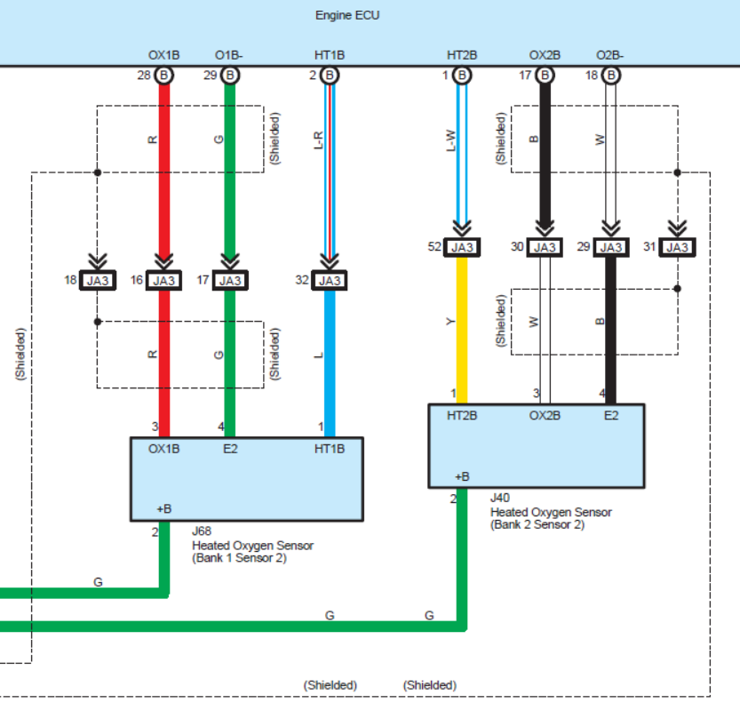

OK so I placed the extra resistor across the lines just like the drawing and just like how I tested indoors with the battery. It is still reading 1.27V that makes no sense. So I disconnected the connector on the cars connector that goes to the ECU and with the car running and the O2 sensor completely disconnected I measured the blue and white wires using a DMM and from what I understand the voltage reading is supposed to read directly from the O2 sensor as it heats up from the cats. I was getting a very low reading but then when I plug the connector back on to the car connector then the voltage reading on the DMM shows as 1.27V. so this high voltage only reads when I connect it to the car. So disconnected the connector again and measured the two pins on the ECU plug and no reading. When I connect the connector up again then I get 1.27V again. What could be wrong?

That makes absolutely no sense. The ECU in this case is not supposed to source voltage. A heated up O2 sensor generates a voltage proportional to the O2 it senses. That signal or actually voltage level is routed to the ECM for reading. Beyond that I have no idea how you can be seeing what you are seeing. It's like where the hell is it coming from? Weird? Open connection somewhere? There are ways that a signal could be injected but that's where things start getting a little complicated.

It makes absolutely no sense to me either. From what I understand the two black cables are supposed to be heating cables. But the white and blue cable is supposed to give a voltage reading back to the ECU based on the heat inside the catalytic converter which heats the sensor which then generates a voltage based on that temperature right? But where could this random voltage be coming from? Before I added the resistor and capacitor it wasn't doing this, do u think I should try and remove it completely and wire the two wires back normally and measure voltage and see? If it doesn't read the strange voltage then something with the RC filter is causing it right?

Are you certain that the oxygen sensor is not a temperature dependent resistor, or semiconductor, and that the ECU is not supplying a bias to it? That would explain the 1.27 volts. This is the explanation that makes sense to me.

OK, so on Saturday i think what I will try is completely taking out the RC filter and wiring the white and blue wires back together directly and measure what the voltage reads. I was just thinking to test if I can actually send a specific voltage to the ECU and read it with the scan tool. So what I was thinking is maybe get a AA battery with resistors to make the output equal half the voltage of the AA battery and then connect that output to the ECU end of the connector seeing as I am going to cut the two wires again anyway and then see if the ECU reads the voltage that the AA battery is sending? If that works, is there not a way to make a device to just constantly send the correct waveform voltage to the ECU and just cut the two wires from the O2 sensor off and cap it off? What does the heater wires do for the O2 sensor? Below is a section from the wiring diagram for my car that shows the 4 wires going to the O2 sensor, I am working with the Bank 1 sensor 2.
How would I determine this? The oxygen sensor has two black wires which are some sort of heating wires I am told but I don't know much more. Diagram posted above. Can you kindly explain how I can test this theory? Thanks

If the oxy sensor is a temperature dependent resistor then the resistance between the black and white wires, pins #29 and #30 will change when it is hot. But if a voltage appears between those wires while they are disconnected from the ECU, then it is not a resistor. And you may have done that check already. One more thing, based on that drawing, is are you sure the polarity is correct? The black to white looks funny to me.

Sorry but, could you revise why you started considering to add a filter? Like it or not that is a modification of the original design. Am I right?

There is no need for a diode. The design is a simple LP (Low Pass) filter. While it will only pass lower frequencies and filter the spikes what the ECU sees will be less than the O2 sensor sends, that may be a downside waiting for 5 RC Time Constants. I have seen it done using capacitor values from 1.0 uF to the 470 uF shown in your drawing. So in this case:
"The time also called the transient response, required for the capacitor to fully charge is equivalent to about 5 time constants or 5T. This transient response time T, is measured in terms of τ = R x C, in seconds, where R is the value of the resistor in ohms and C is the value of the capacitor in Farads".
In this case 470 seconds for one time constant now we get 470 * 5 = 2350 Seconds or about 39.2 min. That's a bit long. You may want to try some lower value capacitors like 10 uF and see how your results actually look. Some of this also depends on the O2 sensor in question too.
Ron
I'm planning on adding a 1Mohm resistor and a 4.7uF capacitor like the picture below on a o2 sensor that generates a voltage from 0 to 0.9v. The plan is to remove highly frequent voltage changes and allow the lower slow voltage changes to happen. Basically frequently changing voltage reports ineffecient catalytic converter so with the resistor and the capacitor apparently this allows the slower less frequent changes but smoothens out the faster frequent changes. This diagram is a tried and tested one based on youtube and the person who did it has had it over a year. My only question is, is there a need to put maybe a diode across from the + and - just like the capacitor?
