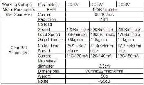

My concern at the time is this one, i have a 7.4v connected to the Vcc2 pin to power the motors, the motors work in a range of 3v-6v, i'm concerned that the drop in the upper and low transistor at the l293d will be so high that the motors wont have the strength to move the car. These are the numbers i have:
MOTOR DATA:
The L293D states a typical 2.6v drop being 1.4v at the high transistor and 1.2v at the low transistor while driving a 600mA load. As i observe in the Gear Box parameters, the max load it will draw is 150mA, so i can expect a lower drop at the transistors right ? But the load of the motors will be decided by the voltage it receives right ? So how to problematize that ? I don't know the exact drop, so i don't know what voltage will they receive, so i don't know the load... I may be lacking some knowledge at this area, that's why i'm bringing this to you guys. So basically one motor per channel, 7.4v battery to feed the motors with the current data chart. Any help of what will happen ? The LM317 idea was to put it to limit the current to the 150mA and don't care about the voltage as Papabravo stated. halp :/
EDIT: I looked at the graph you sent and a motor with internal resistance of 30Ω will receive around 5.75v ? With a 7.4v battery ?

It will be open air, i think it will suffice... I wonder why there arent resistance values for the motors in the data charts, is it variable ?
There are voltages and currents in the motor table. I dont have a Spice model of a motor (actually too lazy to build one) so it was easier to model the motor as a resistor. Actually, as the motor load changes, as the rpm changes, the effective motor resistance (ratio of motor voltage to motor current) changes all over the map.
