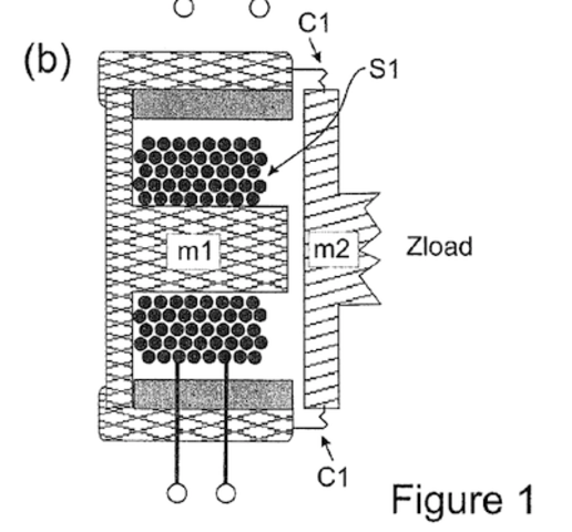

The main point of bone conduction transducers is to accelerate a mass with the audio signal and couple what I guess I can call the "reactive acceleration" of the platform that supports the device that generates the magnetic field that causes the acceleration. In your example with a pencil, either the coil or the magnet (whichever has less mass) would be tightly coupled to the pencil and the other of the two would be loosely coupled as with a damped spring of some kind.
This principle can be seen in the illustration below taken from US patent 8761416.
www.google.co.th/patents/US8761416
In the illustration, a spring-mounted mass is accelerated by the electromagnet mounted in the frame that transmits the vibrational energy to the user's head.

Thanks, Dave. I don't want to use headphones, because the whole point of this demonstration is to show children that sound which they can't hear through their ears is conducted through the teeth. I believe that the magnet and coil are working but the strength of the signal from the radio is too low for me to be able pick it up through the pencil. Hence, I thought that using a small transformer might help. In the original working model, no spring of any kind was used, just a pencil. a rare earth magnet and a coil of wire wrapped around the magnet (and the effect was truly astonshing).

My guess is that your trouble owes to impedance mismatch (radio to coil) -- you may wish to experiment with the turns-count. Be advised that, due to its excessive transformation ratio, the (RS) audio transformer will not likely be of help...
