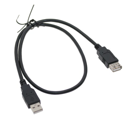

You can get the power from USB +5v and GND, it's enough for the op amp to use. (buy a USB expanding cable, and an USB male plug)
How may pieces of piezo buzs you need, it depends on how many input key you want.

I want to use a total of 12 piezo for the 12 inputs. Will the USB handle the power supply or should I provide external power supply?Is yes how much?

There are many kinds of USB cable, I suggest the type as this.
wikimedia USB knowledge.
The USB pinout as :
The USB male plug as:
Computer USB +5V female plug → male plug, USB cable, female plug → USB male plug, op amp Power.
