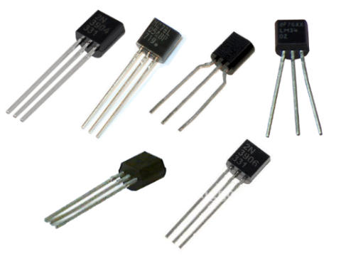

By way of explanation, this is why you do not use pictures of the components when diagramming electronics:
Each and every one of these devices, if substituted for one of the others in a circuit, would at best result in a non-functional circuit. At worst, they would fry themselves and/or the circuit they're installed in.
