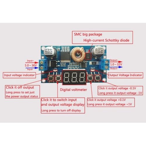

Edit: We can decrease dissipating power of R3 up to 6W, using module $5.98:
https://www.ebay.com/itm/5A-Digital-Control-DC-DC-Step-down-Power-Buck-Module-5-36V-to-1-32V-12v-5v-24v/152228350713?_trkparms=aid=444000&algo=SOI.DEFAULT&ao=1&asc=50998&meid=fc8f12c7ca354915bb156c4c6193eef6&pid=100752&rk=5&rkt=6&sd=152332717605&itm=152228350713&_trksid=p2047675.c100752.m1982
Even more: we can put new resistor R4 about 40 Ohm, in series with D1, then we will see tested wire state on display (Input voltage of converter).
Lower voltage - lower resistance of wire.
