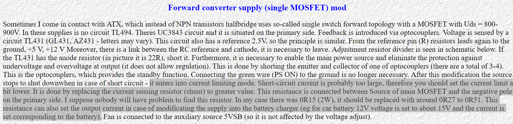

Short out Q2 c/e terminals, this will keep the chip power on and prevent shutdown.
As for the opto led, yes this is the one that regulates the voltage.
I see, Q2 goes to pin 8, danyk never mentioned that.. he only said "This is done by shorting the emitter and collector of one of optocouplers" not any transistor.. thanks.

I would try to trace the circuit out around the Uc3843 chip, and see if it compares to the circuits i posted...that way you will have a better idea how to modify it!!

Thanks for all the help, i have now disabled the ovp, and i can increase the voltage up to 15v without shutdown (i didn't go any higher since i haven't replaced the caps yet). But i have a problem, i cannot go lower than 11.8 volts.. i have a 1Mohm pot connected, if i measure the resistance when i have it mounted to the circuit, it shows a maximum of 1.8kohm instead of 1Mohm.. any idea why i can't go lower than 11 volts?
Update: Just replaced all the caps that was rated for 16 volts to 25 volts ones, gonna try to increase the voltage to around 18 volts. Will report back.

Danyk said this:
Was he wrong? Or did i get something wrong? And thanks, then i will replace the caps with even higher voltages to be on the safe side.

Btw, did anyone know how to calculate the shunt resistance? If i want to limit the current to let's say 15 Amps. what does the value need to be? Thanks.
