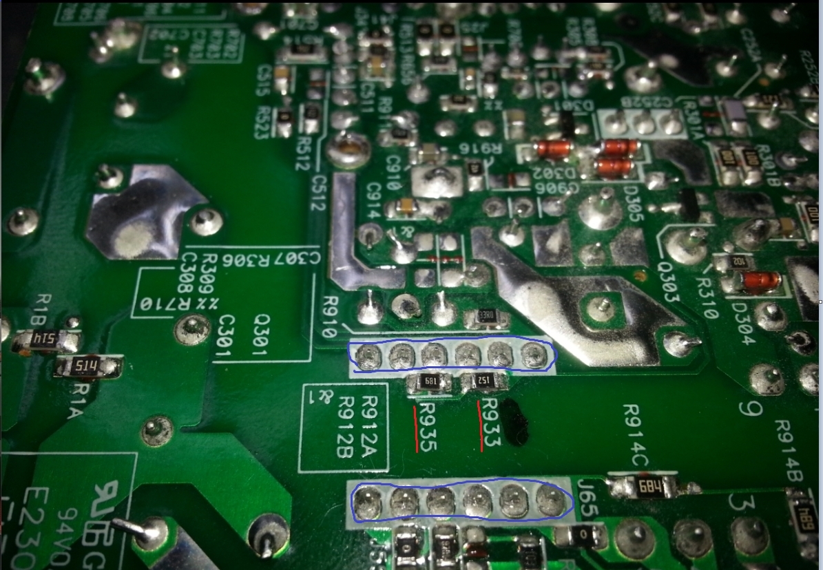

A small update. I found two SMD resistors, one end that goes from an octocoupler, and the other goes directly to the REF pin of the TL431.
R935 and R933 is the two resistors. The octocouplers is the one in blue.
Edit: Dammit.. i just noticed enother TL431 behind the heatsink covered in that yellow gunk.. So there are 3 of them in total.

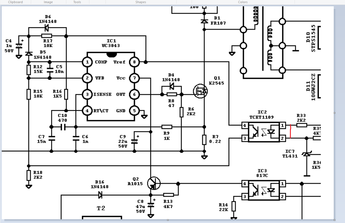

Your atx will be using an opto coupler to sense the voltage feedback on the Uc3843 chip pin 2, with a Tl431, if you can retrace the circuit around this pin the Tl431 uses two resistors to set the firing point for the opto.
Looking at your pictures in the first post, there are 3 optos under the heatsink.
http://danyk.cz/s_atx_en.html

Yes, its getting a fixed voltage from pin8, that circuit is regulated by the opto pulling the Vsense pin to the Vref supply to shut it down.

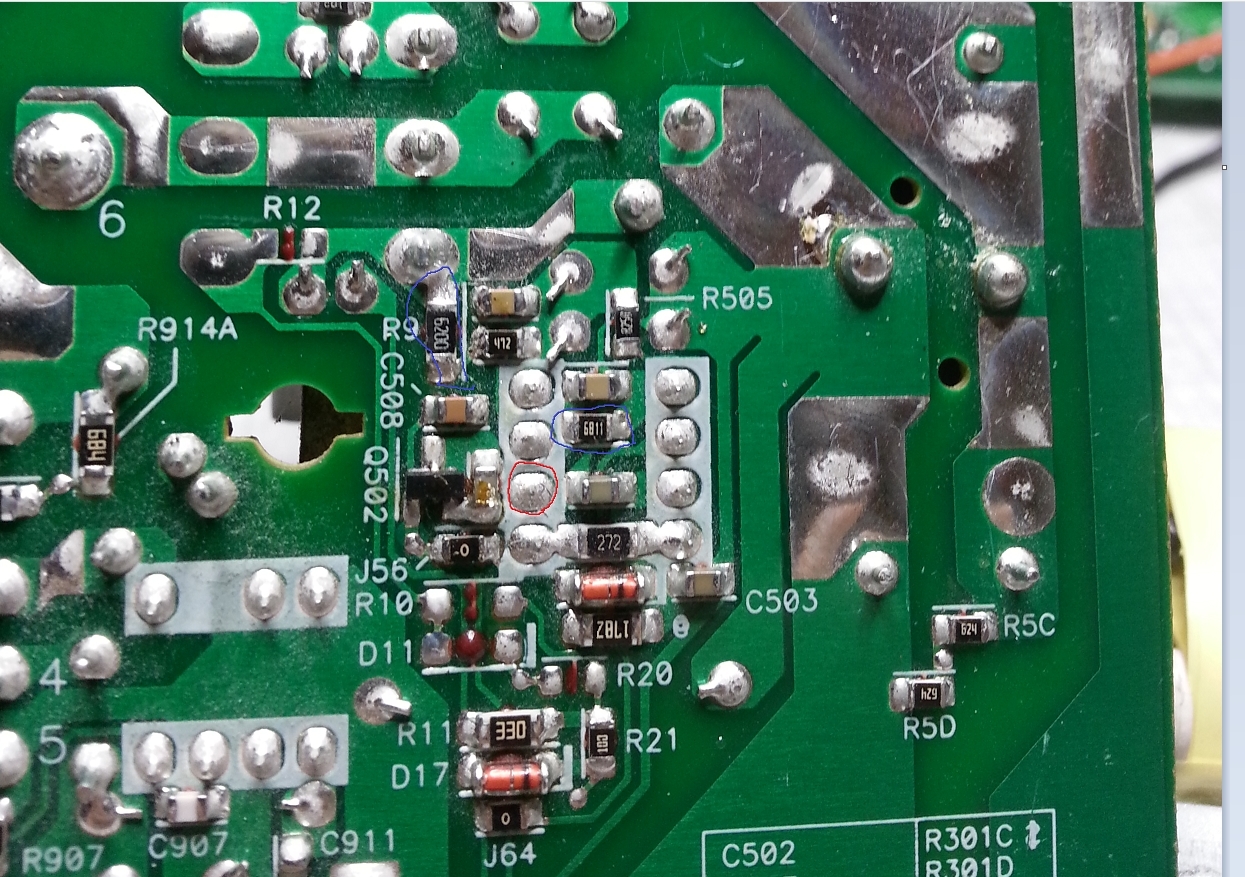

Update:
The pin in red is the pin 2 of the UC3842, and the two resistors in blue is the two resistors that pin 2 goes between so my guess is that those two is the divider network for the UC chip (since it's on the primary side i won't mess with that). just wanna report some progress!

If that's the case, follow pin 2 it should go to an opto coupler, that will have a Tl431 on the 12v line,,, or you can alter the resistors on pin 2.

Also, the layout is very similar to the picture i showed: http://danyk.cz/s_atx06h.png
If that is the case, which is the resistors i should alter? the R36 and R37 after the TL431? Thanks

You could lower the resistor on pin 2 to ground, this will alter the feedback loop, and increase the output voltage, or lower the resistors R36/37,, but if there is a shutdown OVP chip that will need to be disabled.

Update: just noticed that my ATX didn't have a single chip for the protection which i thought it would: http://danyk.cz/at_atx_en.html
If you check that sight and then "Forward converter supply (single MOSFET) mod "
He said: " This is done by shorting the emitter and collector of one of optocouplers (there are a total of 3-4). This is the optocouplers, which provides the standby function."
Does it matter which one i short or can i short anyone?

You can only short out the led side of the opto, the one that feeds pin 2/8...
Thanks, just to be sure, you do mean like this:
right? The guy said "Optocoupler, which turn on the supply from the standby mode. Short the emitter and collector together (they are on primary side). " I tried doing that but the supply wouldn't power up at all..

Short out Q2 c/e terminals, this will keep the chip power on and prevent shutdown.
As for the opto led, yes this is the one that regulates the voltage.
