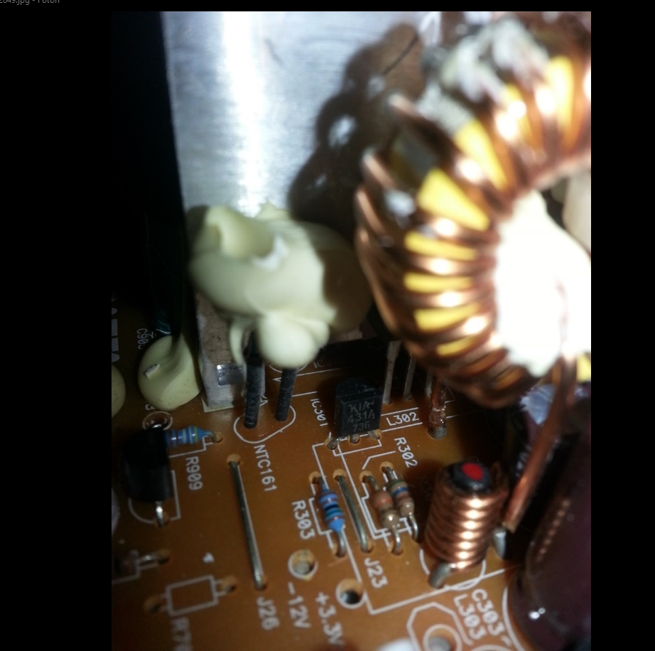

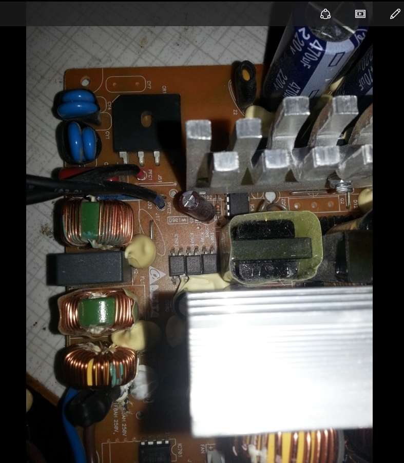

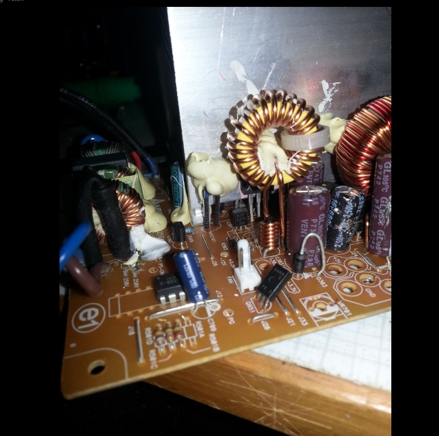

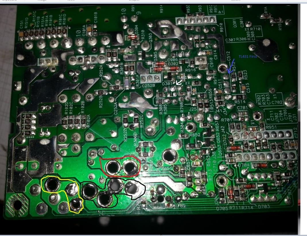

I know there are a few threads and a lot of into on the web on modifying atx to get higher outputs. But since many atx are different in designs (and schematics are hard to find) I'am pretty lost. Here is some pictures to start with:
I have desoldered all the wires for the power and ground since they where in the way of pictures + it's easier to work. Will solder back some new thick wires if i get this to work. The PSU have two TL431 on it, which is the voltage reference. My guess is that one of them is for 5v standby and the other one for the 12v rail but i'm not sure which one. I'm having a hard time locating the feedback resistors for the TL431. Any idea where to start? The ics on the supply are: DWA108-A, UC3843B, TNY267PN. and then two TL431, thanks!

I've done that mod once. I just stripped all non 12-volt circuit related components off the board and then changed the voltage divider network that the 431 uses to read the 12-volt output through a pot to make it an adjustable 12 - 15 volt power supply.
It had no problems running at near the max wattage rating of the power supply like that but the first time it got shorted the whole line side switching system gave up on life. :oops:
Your 12-volt fan should have no issues with running at 15 volts though. I've done it many times.

That's nice! Exactly what i wanna do, any tips for me on how you found the divider network? Been looking with my multimeter for two hours now, I can't find any resistor that goes from the cathode/or the Reference pin of the TL431 to any resistor on the board (except a few SMD ones under the board)

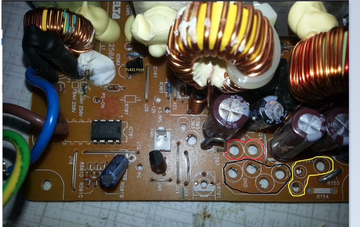

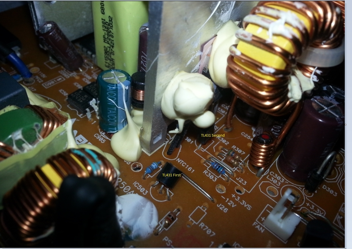

Typically the TL431 and the feedback circuit optocoupler are powered and sense off of the 5-volt power rail so that where you need to concentrate you poking around.
The optocoupler should have its power feed through a resistor from the 5-volt rail then out to the TL431 IC which should have one pin to the main ground plane of the DC side of the power supply.
The one remaining pin of theTL431 should be attached to the midpoint of a two resistor voltage divider where one resistor goes to the ground plane and the other goes to the 5 -volt rail.
The how and where of that layout is up to you to find but once you do it should just be a matter of cutting the circuit that feeds from the 5-volt rail and adding the right resistance for it read from a tap off of the 12-volt rail.
A clear picture of the board form the top down and the bottom up of the DC output side would be helpful on our end so we can see the component layout and the circuit traces separately.

Here are some more pictures:
Red = 5V
Yellow = 12V
Black = GND
