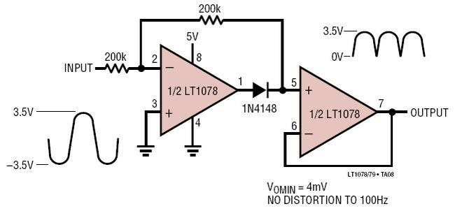

In post #49, a 3.5V AC signal is transformed into a 3.5V rectified signal.
Isn't that how the 'Precision full wave voltage rectifier' designed to work as per the LT article.The main design of the circuit was to get the same output voltage as the ac signal.
I was using that as a reference in the design and the third opamp U3 was something i was just following your advise.
Yes, The LT article describes a circuit that takes a 3.5VAC signal and turns it into a 3.5V rectified signal.
The problem is that placing a low value shunt in the high current circuit cannot possibly give you a full 3.5VAC signal to rectify. It can only give you millivolts.
You have been trying to make your circuit give a 3.5VAC signal to match the LT article. You have succeeded in simulation but in real life you will not see that.
We need the circuit to do something more than simply rectify, as the LT article describes. We need it to rectify, and amplify.
Actually in the course of writing that last sentence I have realized another obvious thing that I missed.
That 2nd opamp (on the right) in the LT article is an amplifier with a gain of 1.
We need one with a gain of 10. That's the 3rd opamp in my circuit. But we can simplify by giving the original opamp a gain of 10, and getting rid of the 3rd opamp.

When you measure a voltage in LTSpice, it is assumed you are measuring from the common ground point - assume you have your black DMM probe clipped to the little triangles.
So when you click to measure the voltage at the left side of your 168k resistor R3, you are effectively measuring directly across the transformer secondary - the entire source voltage:
And when you do that, you get an AC waveform of 3.5V.
Does that seem right to you?
You have a transformer putting out 3,500+ Amps through a combined resistance of 0.0009 Ohms, and his output is still a full 3.5V, as if he were unloaded?
That does not seem right to me. It is not right.
I have run my spot welder to that many amps, and the voltage drops practically to nothing, less than 1VAC.
This is what I mean when I talk about the "perfect" or "ideal" transformer in simulation. The transformer does not behave as a real life transformer should; his voltage does not drop.
So your circuit, which is based on having a 3.5V input, is not going to work.
This is why I stress that we measure across a known resistance, a "shunt", which is simply a section of the welding lead.
The voltage drop across a known shunt resistance will give a very accurate amp reading, no matter whether the transformer output drops to 2V, or 1.5V, or 0.2V, or whatever, it doesn't matter.
As long as you design for that millivolt signal, your transformer can drop to whatever voltage it feels like, and you'll still have accurate amp reading; that's why I said that inputting the impedence of the transformer into sim doesn't matter now - because we're only (supposed to be) looking at that millivolt drop across "weld_cable"
Now look at the difference between where my ground point is, and where your ground point is. Here's mine, and see that I'm only looking at the voltage drop across that shunt, not the entire output of the secondary winding:
See how instead of grounding it at the bottom of the screen, I grounded it between the two resistors? this means I only measure across the shunt. And this gives me the millivolts signal that I need.

OK one last bit of input before making the board...
R3 in my circuit (9k resistor). I would make this a potentiometer actually, so that you can adjust the output gain. 0-20kOhm would be good
Currently our circuit gives 3.5V rectified for 3500A.
If the welder doesn't actually put out 3500A exactly maximum (more or less) then you might need to adjust R3. if the shunt value isn't actually 0.0001 ohms then you need to adjust R3
Ideally you would dial it in for 5V at max amps, not 3.5
Would be easier to do that if R3 was a pot.
Would be best if the op amps power supply was more than 5V.
5V is what came from the original circuit from LTSpice website, and we just stayed with that value.
it should be about 10V or so (max 22V)
I assume you are using something higher than 5V for the arduino, so maybe just use that.
if not; if all you have is 5V then that's probably still fine, just don't expect to get 5V out of an opamp who's supply is only 5V. They only go within a limit less than supply voltage.
if only 5V is available then maybe scale in the arduino for max @ 4V.
