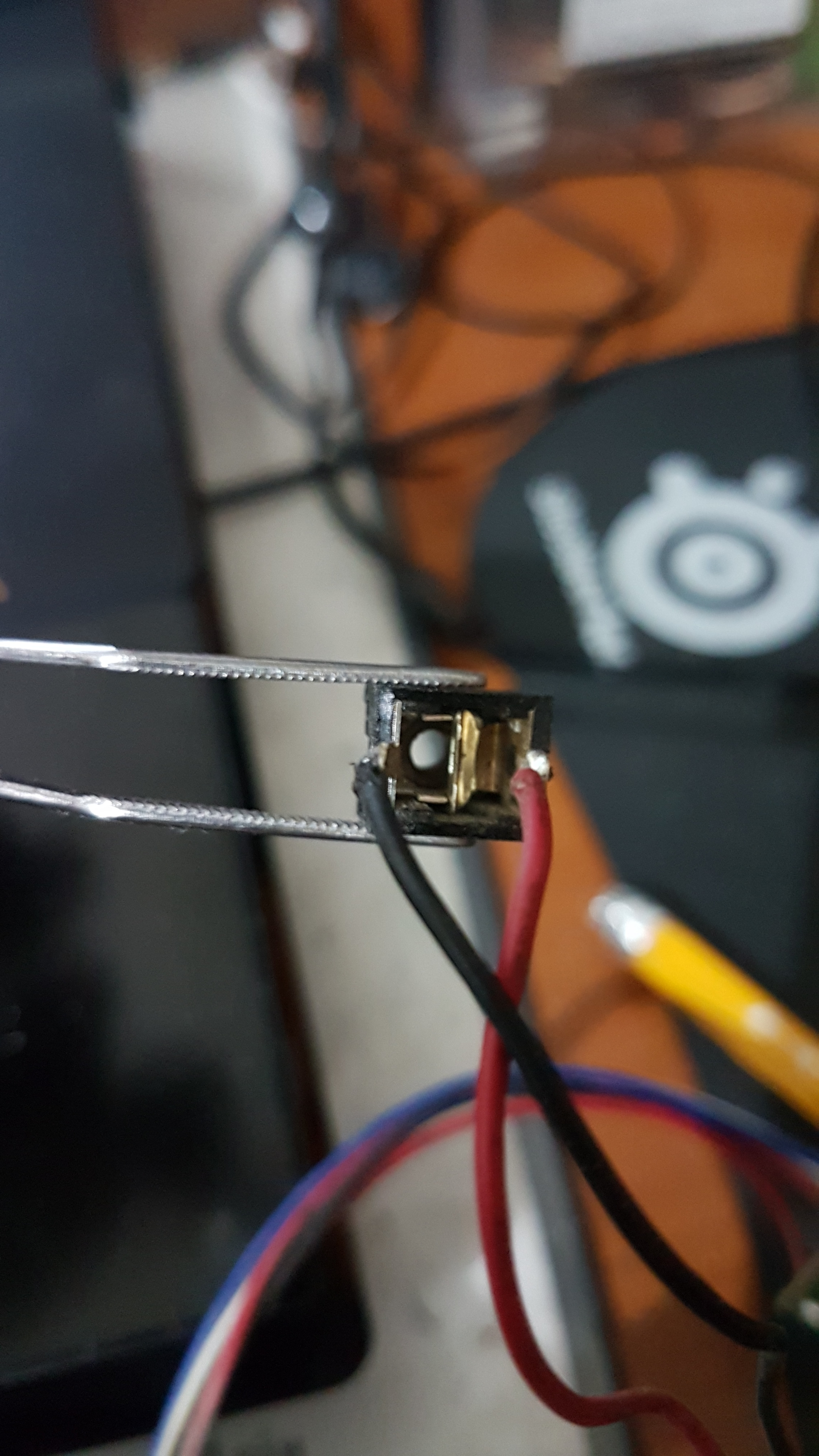

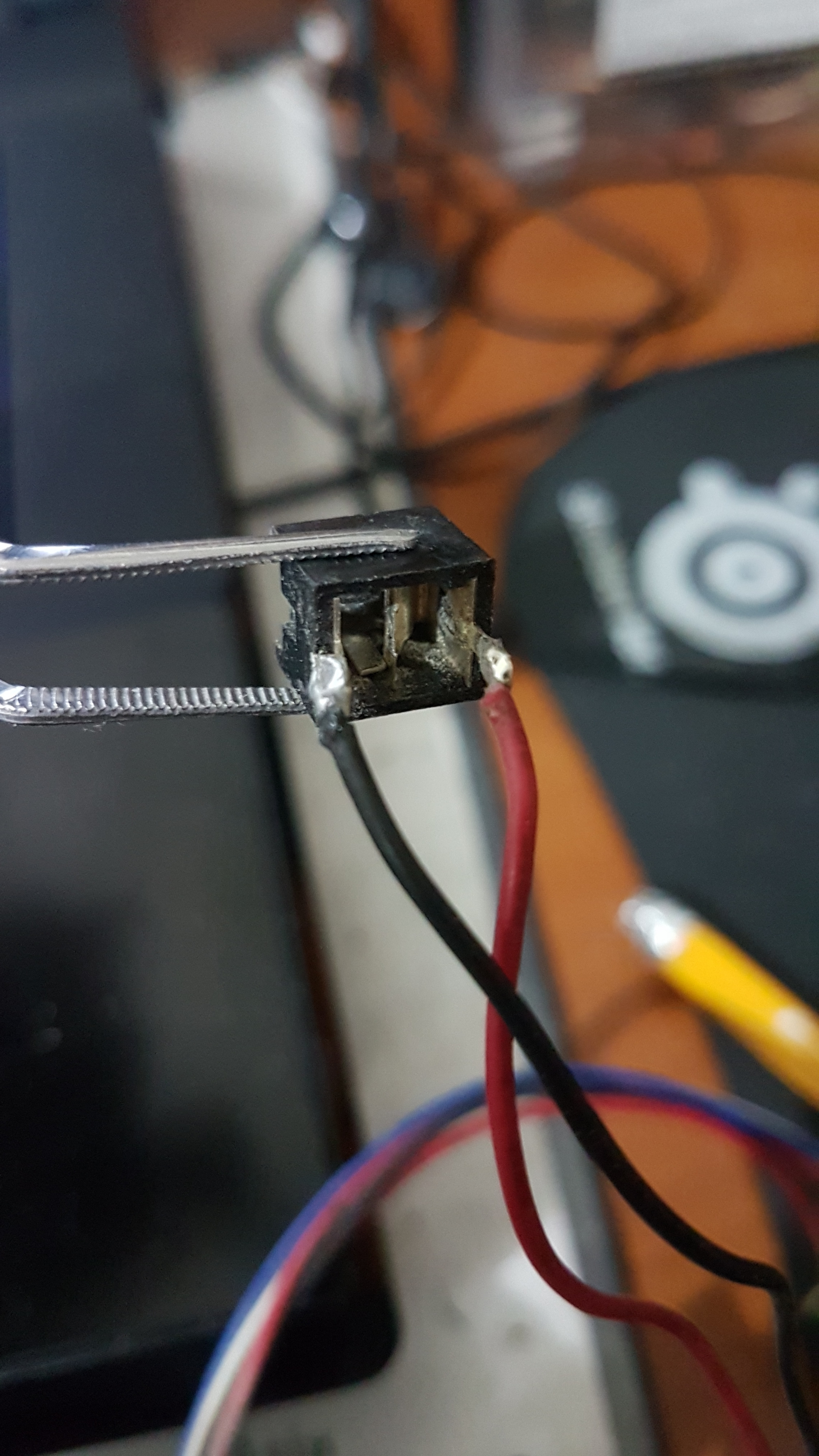

So, I disassembled and found a floating wire (black wire) and I soldered it to where it should be.
I'll share a few links with pictures I took from the "thing" this black wire should be connected to.
https://i.ibb.co/r5dCjzh/20220123-203932.jpg (this "thing" connects here in the PCB)
https://i.ibb.co/4V268nz/20220123-203839.jpg
https://i.ibb.co/ZfQh9k9/20220123-203902.jpg
https://i.ibb.co/k0FkLct/20220123-203635.jpg
https://i.ibb.co/6YBDC9q/20220123-203816.jpg
https://i.ibb.co/0fkmp03/20220123-203701.jpg
https://i.ibb.co/85NZVC3/20220123-203805.jpg
I have no idea what this is, but this is not accessible from the outside of the appliance. It was inside the case. I can only think this may be some sort of protection, because the metal plate of the red wire seems to be some sort of magnetic switch, as it is in a V shape and it's making contact with the plate of the black wire.

yup, mono jack.

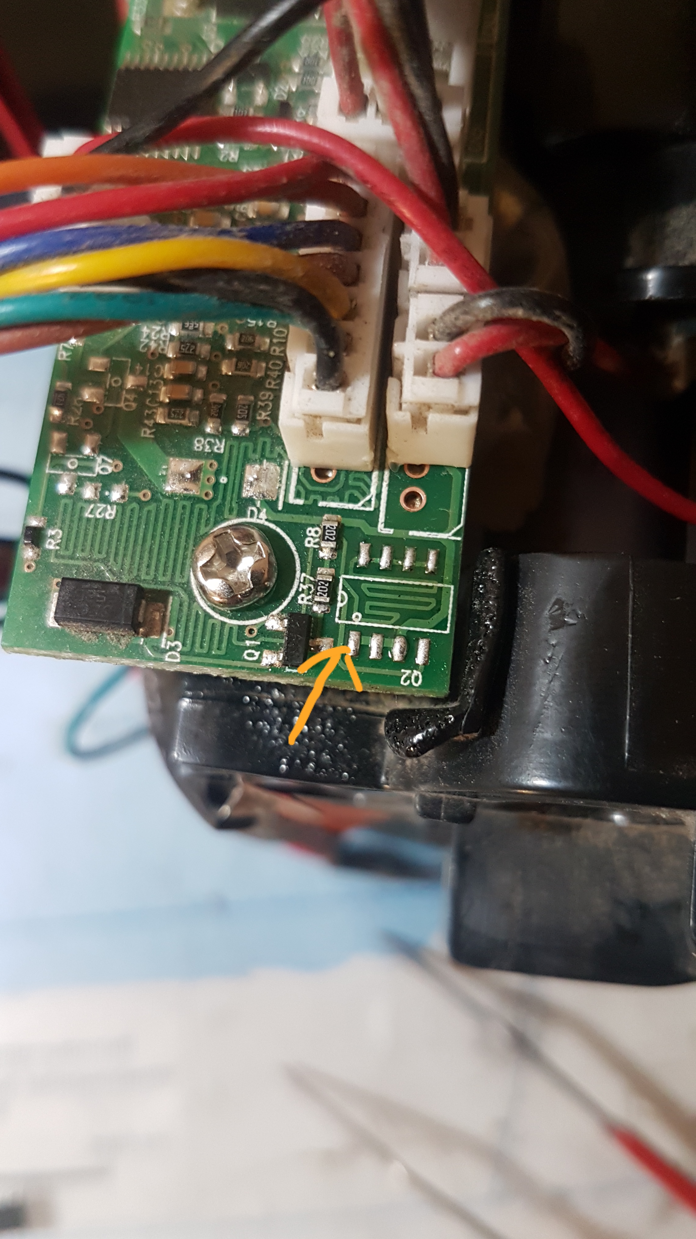

I took some pictures of this board. Maybe someone have a clue of what else I can test/measure to try to sort the problem out.
I tried the motor out of the circuit, using my PSU. Despite the fact that my PSU can't deliver the required current, the motor works (by dropping the PSU voltage).
What else can I do?

It appears that Q1 drives the 8 pin Q2 via R37 (a guess). Check Q1, for if it is bad, it may be turning on the gate of Q2 100%.
Also, your Q3 looks like it has been running hot on that board. I would check that device as well.

How are you counting pins?
2 4 6 8
1 3 5 7
or
5 6 7 8
1 2 3 4
I assume one of the ways above. But by what I can see from the screen where I have removed the MOSFET, it seems R37 goes to the gate of the MOSFET, at pin 7 or 4 in the representations above.
Edit;
So, I can confirm that Q2 pin drives/is connected to MOSFET pin 7 (or 4) via R37 (2kΩ resistor)

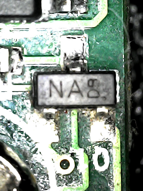

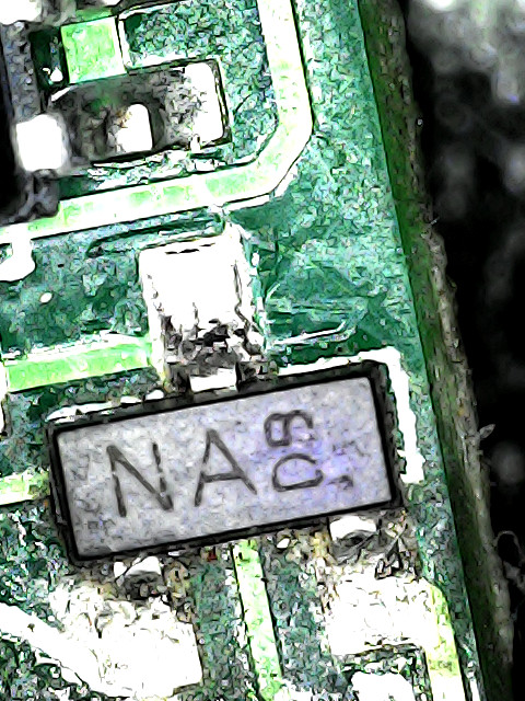

Can this component be identified?
It's the mentioned Q1

Can't identify the NA or D? device. If D8, would be one thing, DB would be another...
I can't tell for sure either. This is the best I can get from the usb microscope!
