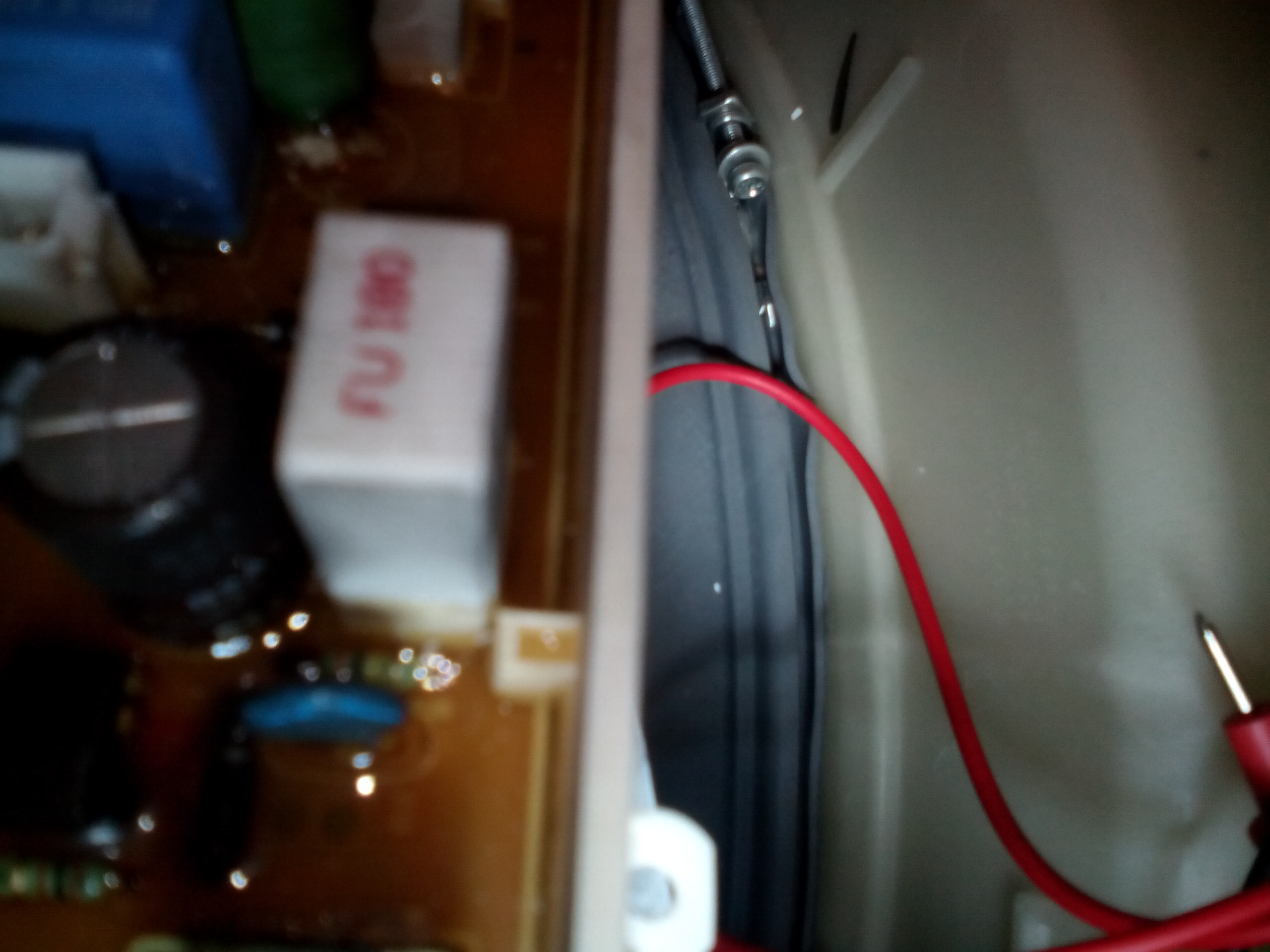

Ok, my mistake. Was testing the wire side. Here are the actual numbers...
CN4-L1 = Nothing/2.2ohms
CN4-D20 negative = 2.2ohms
CN4-D22 positive = 2.2ohms
It looks like the board in the picture is held in with plastic clips. I can only see one. (There will be more.) It is on the top edge of the plastic housing about a third of the way from the right hand side. It looks like pressing it towards the edge of the moulding will allow the board to be lifted out. It may be difficult to release all of the clips at the same time.
Les.
Its not a clip but rather a wedge (fixed) to keep the board permanently secured in place. That's the only one that looks like that, the others around the board are squarish as shown in below picture. Sorry, that's the best by phone camera can do.

Ok, i just tested again (actually earlier) and now i'm getting 01.7 between CN4 & L1 on the wire which was reading 0.00. It took a good 5 minutes of persistent probing it get a reading. There is some sort of protective (?) black chalk on the wire...i guess that and the putty made it difficult for the probe to make a clean contact.

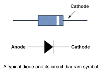

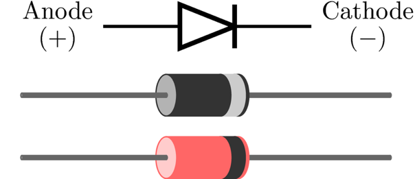

Yes you are correct. (The end of the diode marked with a band is the positive end.) Again be VERY CARFULL. Although you are only expecting 12 volts DC between those two points they will both have 220 volts AC on them with respect to earth. This is enough to kill you if you touch them.

I just noticed something. You said in an earlier post that the side of the diode with the band is the positive end. Was that a typo?

I always think of the cathode as the positive end (Which is technically wrong.) as it will be the cathode that gives the positive output when used as a rectifier. For the diode to conduct the anode must be positive with respect to the cathode. When used as a rectifier the anode will be about 0.7 volts more positive than the cathode. (The positive output.)
