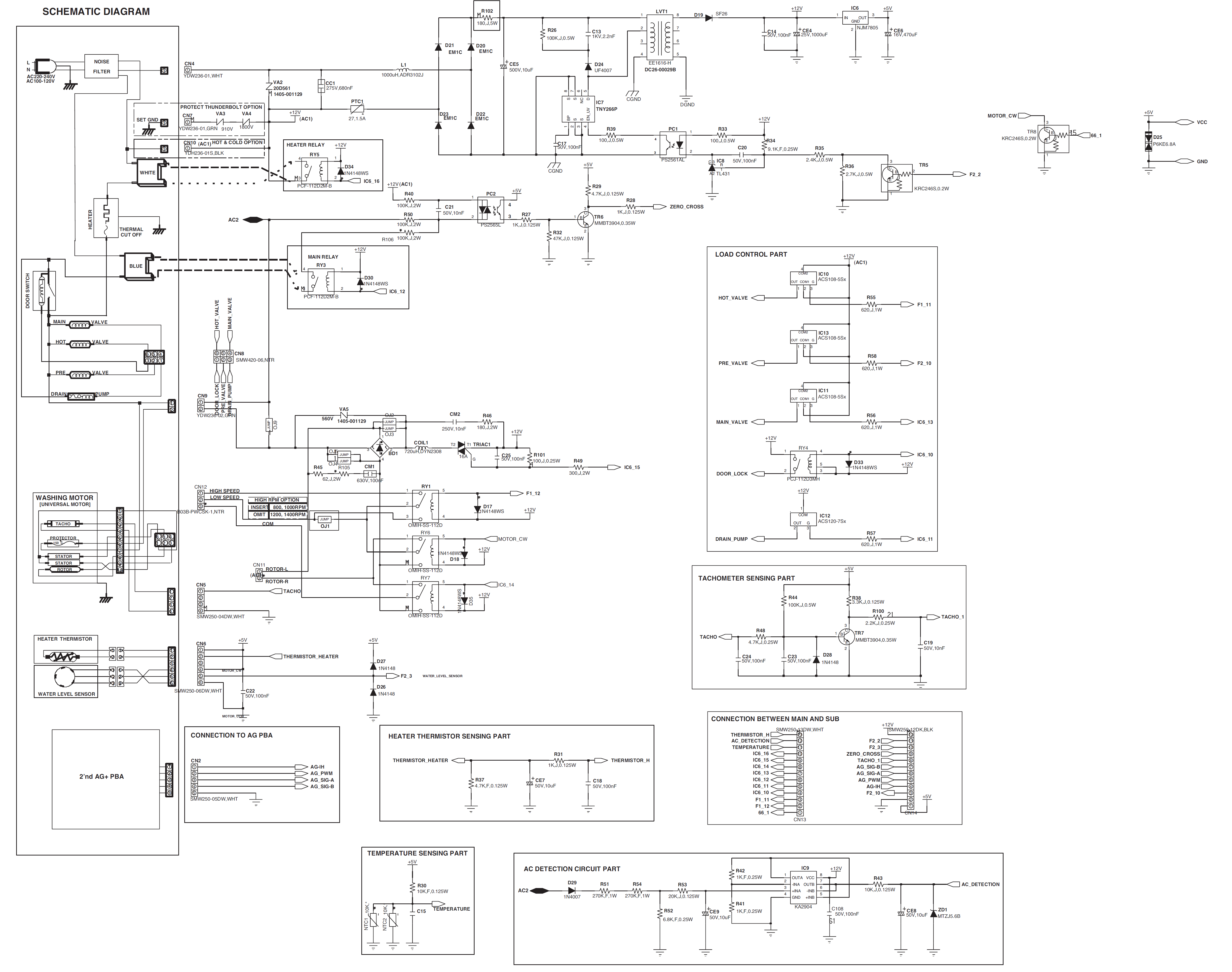

Location 1 Main Relay says it receives 230 ACV to operate the PBA. My guess is you should see 230 ACV between neutral and those relay contacts, both contacts when the relay is energized. I would guess for that relay to energize there is a "permissive loop" of conditions which need to be met. Things like door lock etc. If neutral to those terminals you are only seeing 93 ACV and you have 230 ACV mains something is wrong.

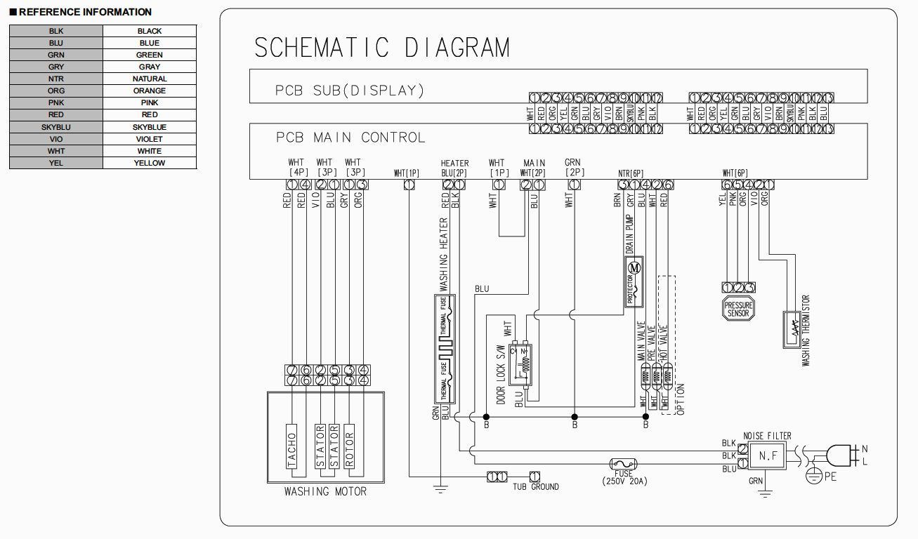

Funny you mentioned the door lock. Manual says i should see about 940 ohms testing the door lock switch. I am seeing 720. Does that mean its defective?

If I mentioned 120 V it was likely my bad before I knew what the mains voltage was (220 ACV). Unfortunately when I click on the drawings to view yhe left side the image shifts. Washing machines normally have what I call a permissive loop meaning certain conditions must be met before other things can happen. Part of this becomes a matter of looking at the drawing and trying to understand what happens when and what is necessary for things to happen. I doubt the door switch is bad but don't understand the resistance?
Am I the only one having an issue with expanding the drawing and not being able to view the right hand side?

You're not the only one. I just tried clicking on the image and same thing, right side doesnt show.
You can go to the links directly to see the pictures. Alternatively, you can right click on the pictures and save them to your computer.

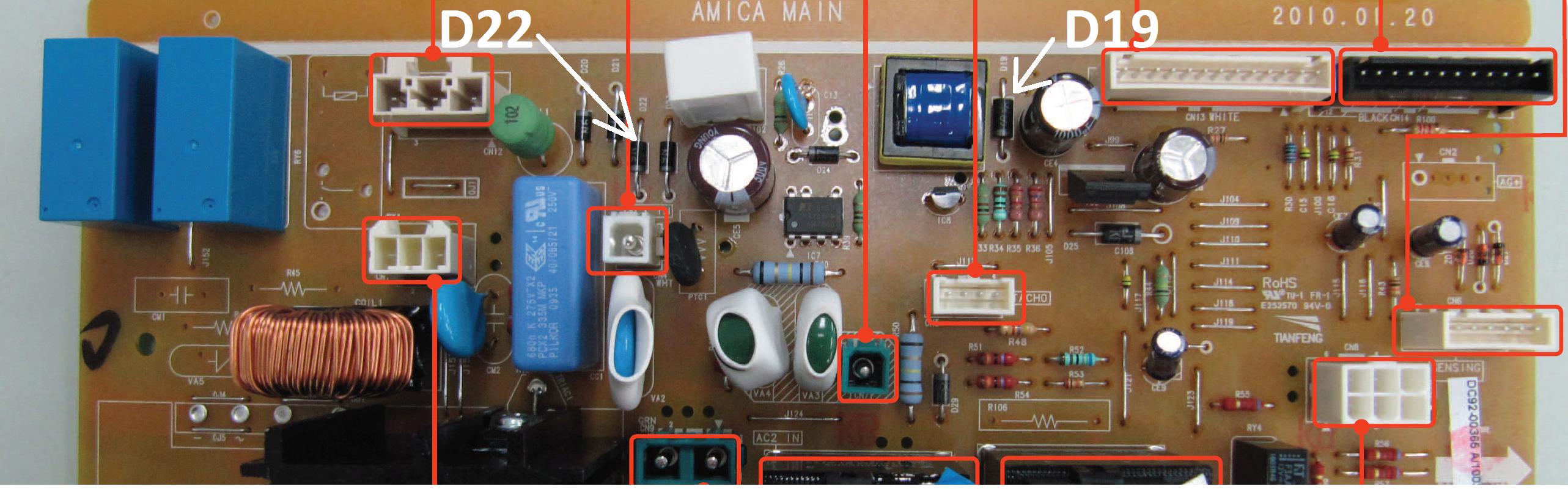

It is possible the relay is not closing because the 12volt DC supply is not working. Can you measure the voltage between D22 negative and D19 positive. BE VERY CARFULL DOING THIS AS BOTH POINTS WILL PROBABLY BE AT A HIGH VOLTAGE WITH RESPECT TO EARTH

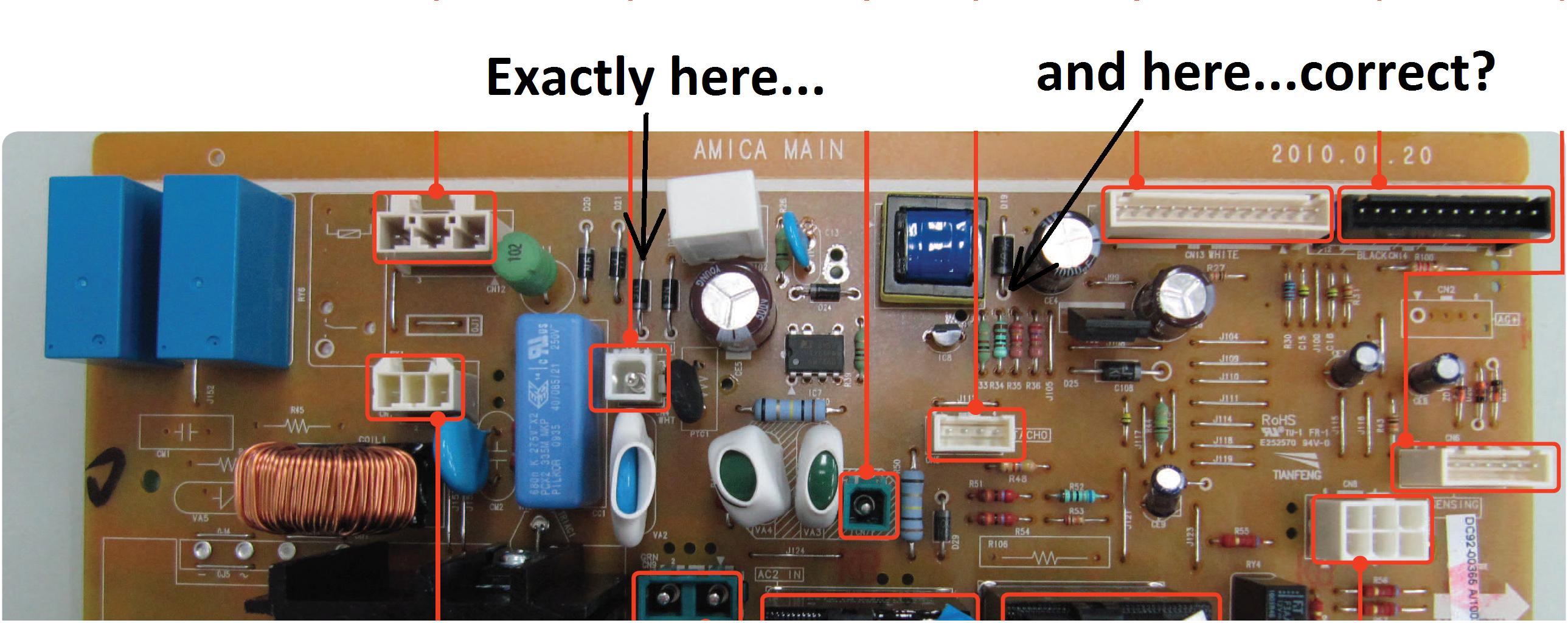

Could you point me in the right direction...Where is D22 and D19. It's Saudi Arabia.

Look at the PCB or the pictures in post #20

OK! Found D19 and D22 on the board. Are they diodes?? How do i go about measuring? Is it one probe on D19 and the other on D22 with the multimeter set to 20 DC voltage?

Yes you are correct. (The end of the diode marked with a band is the positive end.) Again be VERY CARFULL. Although you are only expecting 12 volts DC between those two points they will both have 220 volts AC on them with respect to earth. This is enough to kill you if you touch them.

OK thanks. One more thing, I can't access the reverse side of the board so is it ok to do this test on the the component side (the side on the picture above)?
If so, then it's one probe on D19 positive side (the side with the band on the diode) and the other probe on D22 negative side (the side with no band on the diode)...right?
Any idea how i can get through the protective silicone putty on the board? Would poking a needle through to the points and then touching the probes to the needles do?
