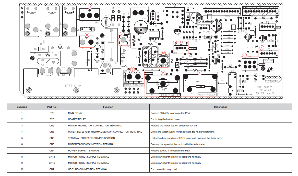

How do you test this relay?
MaxHeadRoom
Joined Jul 18, 2013
30,857
If absolutely sure you cannot get to the reverse side of the board, run the machine with the two top wires disconnected.
Wait and see by sound or by holding the relay (or both) when it becomes energized, measure the resistance across the two terminals.
Max.
Reloadron
Joined Jan 15, 2015
7,962
My guess is that you can measure across terminals 3 & 4. Those should be the top terminals (spade lugs) contacts. Depending onthe relays use in the circuit if it is energizing you will likely see some small AC mV reading and when the contacts are open a higher AC voltage depending on what the relay is switching.

Can't get to the reverse side of the board :(
What do you want to test?
If it's working
Max.
That's the problem. The machine (washer) is not turning on. I am trying to figure out if the reason is this relay.
If you can't access it then you can't replace it. So why bother testing it?
Good point. Just trying to rule it out. That means, if it is working than i can look elsewhere for the problem.
Ron
I am seeing 0v. Nothing. The machine is not working - hence the quest to see if the cause is this relay - so i have no idea if its energizing or not.

Well, kind of. Its in a plastic casing which has to be cut open to get to the back of the board. The model number is Samsung wf0500nce. Searched all over the Internet for the service manual to no avail.

Could you please elaborate,
Sure. The terminals you have easy access to look to be the contacts. Measuring across contacts using AC Volts scale you should read zero volts when the contacts are closed, like measuring across a closed switch. Measuring across an open switch you should read close top line voltage. That should tell you if that relay is energizing and the contacts closed when energized. That assumes you are switching line voltage. Next if you measure from mains neutral to those contact terminals one terminal will always read mains voltage and the other terminal should read mains voltage when the contacts are closed.
Also per Max if you disconnect the spade lugs and set aside so as not to be a hazard you should also be able to feel the relay click when it energizes. Additionally measuring resistance it is like measuring across a switch. Open or closed so infinity or less than one ohm when the relay is energized.

I just tried it. Didnt hear or feel a click. But if the machine is not working (on and off button not doing anything) how do i turn on to hear/feel the click? At the plug? Also i just discovered that there is no power at the connectors which go to the relay.
But how do i open the switch? It's a push button switch.
Yep, im showing 125v at terminal where black wire connects to. Why is that though since the power source is 220v?
How do i energize it though, to perform this test?

Correction: I am showing 93 volts, not 125 volts...like i said in the previous post. What does that mean?
