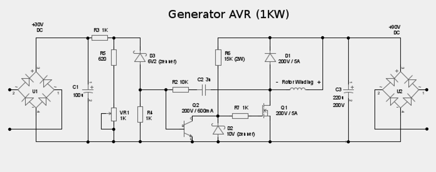

    I guess you could find the appropriate parts (Mosfet, freewheeling diode and high-voltage dc link capacitor) on a PSU/UPS board. A 200V/10A Mosfet could be enough, by example (though you could find a higher rated one in those scrap boards).
    Btw, you could replace the frewheeling diode (D1) with a Mosfet (as it has a built-in body diode rated at its Vds/Id).

    Sorry, you're right.. I misread those handwriting annotations (I've read "100V" instead of "200V").

    I the near future, I will give up this discrete components solution and use a dedicated (PWM) IC instead (like UC3843, for example).
    That way, you could switch the Mosfet way more efficient, use a much higher switching frequency and have a better output voltage regulation.
    For now, I'll try this emergency solution as I need to use the generator this weekend. ;)

    When bjt IS ON, mosfet IS OFF and negative brush IS no more grounded. And only the 9v IS provided via this kind of resonant bridge ( cap + res) .. this IS right?

    When the Mosfet is OFF, the inductor current is "recirculating" through the flywheel diode. That's it, the inductor is still energized, even if it is not connected to any power supply. The inductor is operating in continuous conduction mode (CCM).
    What 9V are you referring to?

    Stupid question but i want to understand. What do you mean by inductor ? Rotor winding or feed winding?
    In this case what IS the role of C2 R2 between bjt base and negative brush ? I calculate about 5.7 MHz

    Yes, I was talking about rotor winding. It is actually the Mosfet "load".
    You have to think about R2-C2 as being connected between BJT base and Mosfet drain.
    When the BJT base is HIGH, its collector is LOW, the Mosfet gate is LOW hence the Mosfet drain is HIGH.
    That's it, by connecting a RC network between the BJT base and Mosfet drain you get a positive feedback (oscillations).

    Can i use mosfet irf740 to replace irfs640.
    And a 2n3055 to replace 2n5551.

    IRF740 should work (though the Id rating is only 10Amps).
    You might put a reverse biased diode across the BJT base-emitter terminals (to avoid any collector-base voltage greater than 10V (D2 zenner)) then any regular small signal BJT could do the job (you don't need a 180V rated one).

    I've redrawn the schematics to better understand the circuit topology.
    [​IMG]
    As you can see, it's basically a buck converter (where the output inductor acts as a load, too). The PWM signal is generated by permanently connecting the Mosfet gate to the Vcc bus (through that current limiting resistor) and by the BJT, which is shunting to ground the Mosfet gate whenever the feedback voltage is greater than the preset threshold (VR1).
