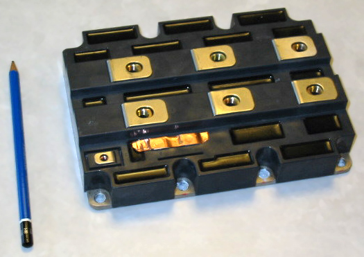

Even at low resistance ON state, the voltage drop across the MOSFET can be more than 0.7V for very high currents - more than you would get from a Bipolar transistor. In that case, the mosfet/BJT can be assembled into a darlington-like device, available in TO-220 to big modules - Insulated Gate Bipolar Transistor (IGBT). Some come with some nice lugs for bolting your crimped-on eyelet.In this kind of circuit where the "go" signal and the load share the same ground, a mosfet makes a good, low resistance connection and can switch 100 times before a relay knows it's supposed to wake up. This stays true until you get to fairly big amps (like 50 to 75 amps) where the tiny legs on the mosfet and the copper traces on a circuit board start to be a limiting factor. I mean, come on, how do you attach 4 gauge wire to a mosfet so it complies with the National Electrical Code for a circuit over 60 amps? Theoretically, a couple of mosfets could run my air conditioner which uses a 76 amp start surge, but here in the lightening capital of America, I prefer a big, stupid relay for reliability.
That certainly beats trying to solder those tiny legs to a 4 gauge wire!Some come with some nice lugs for bolting your crimped-on eyelet.
