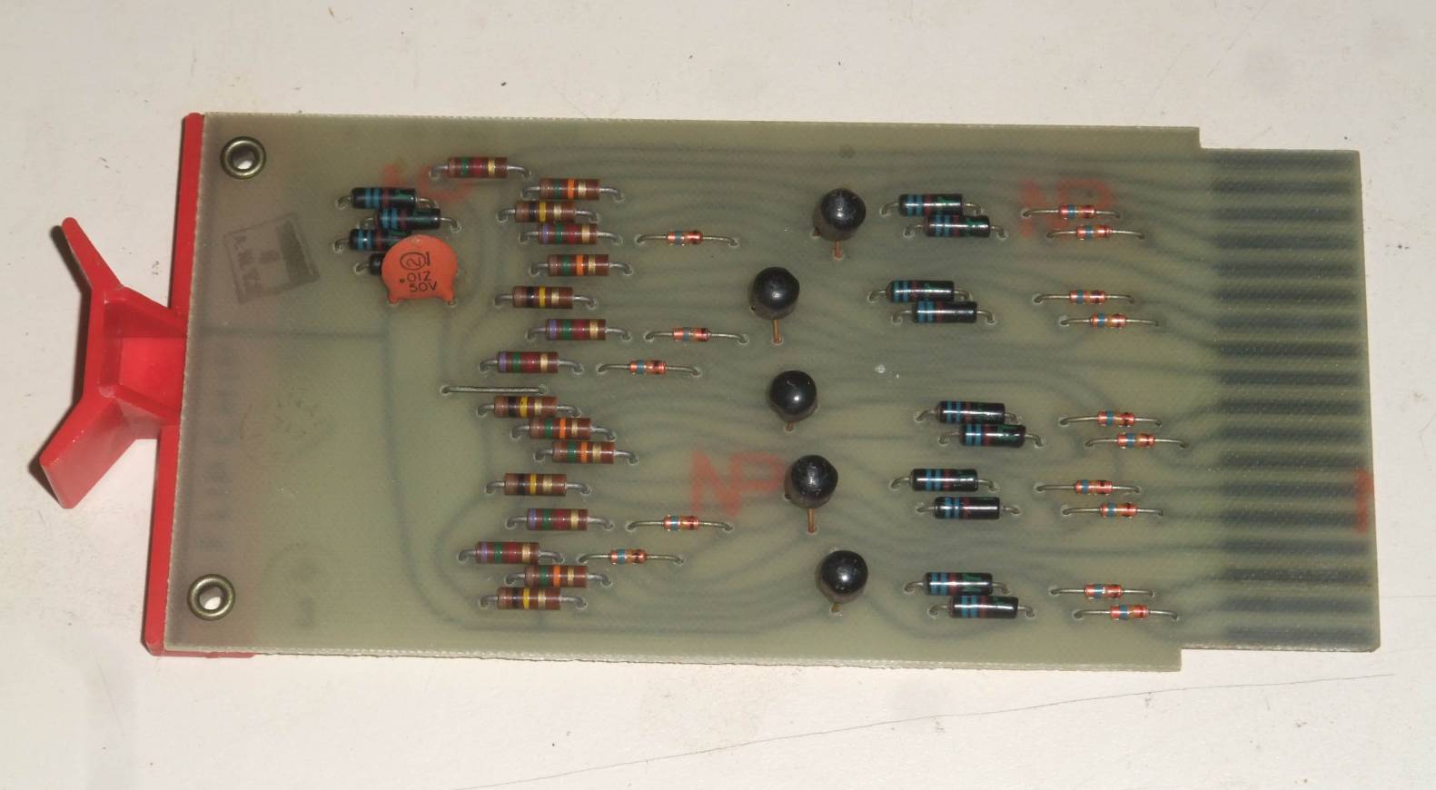

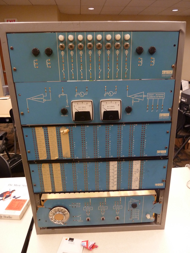

DTL NAND gate is your basic and perhaps simplest logic circuit you can create.
If you want to create your own modules, perhaps there is no need to reinvent the wheel.
Get your hands on some obsolete DEC FLIP CHIP cards such as R113 modules. They are already made for you.
If you can find a DEC 19" rack then you'll be all set to go. This one looks exactly like the one we gave away many years ago.
