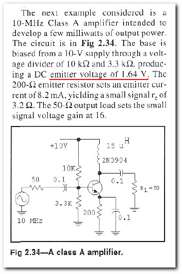

Still I have a last question:
Is adding a series 43 ohm resistance is the only solution to accomplish the impedance matching?
If not, the only solution, does it the best solution ?
To Jony130, and in all languages I say :Simply you forgot about base current.
http://forum.allaboutcircuits.com/threads/transistor-base.81886/#post-585781
If we assume Hfe = 150 and Vbe= 0.7V then
\(Ie = \frac{Vth - Vbe}{\frac{Rth}{hfe+1}+Re } = 8.22mA\)
So
Ve = Ie * Re = 1.644V
Where
Vth = Vcc * R2/(R1+R2)
Rth = R1||R2
R1 = 10K; R2 = 3.3K
