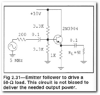

It's the output resistance of the emitter follower, calculated from the intrinsic emitter resistance (dependent on the emitter current), the emitter resistor, and the 3 resistors on the input of the transistor (including the 200 ohm source resistance) divided by the transistor beta.
Please show me how the 3 resistors on the input of the transistor (including the 200 ohm source resistance) divided by the transistor beta = 2 ?? (Let beta = 100)
Thank you very much
Brownout
Joined Jan 10, 2012
2,390
Actually, the 200 ohm resistor is in parallel with the 3.3k resistors. A good estimate of resistance is to consider the 200 ohm resistor by itself, since it's resistance is so much lower than the others. The reason books don't mention it is because source resistance is usually so high that it doesn't need to be considered.
samy555
Joined May 24, 2010
116
I can not imagine it in parallel. Can you help me so that I can be convinced it is in parallel?
It's resistance is not so much lower than the others: 1650/200 = 8.25 . In electronics, to be so much it must be ten times lower!
200/100 = 2 ohm added to 5.9
if it is usually so high In this case, it becomes unreasonable ignored. I mean, it's become big to the point that ignoring it makes the calculations inaccurate
thank you very much
Brownout
Joined Jan 10, 2012
2,390
In the analysis, set all independent sources to zero. Redraw the circuit, and you'll see why it's in paralle.
The other two resistors are 3.3k. 3.3k/200 = 16.5
thank you very much
Source resistance is typically several tens to hundreds of K ohms. But is this case, 200 ohms must be considered.
samy555
Joined May 24, 2010
116
Yes, now I understand, thank you
The other two resistors are (3.3k//3.3K) = 1.65K
1.65k/ beta = 16.5
16.5//(200/beta) = 16.5//2 =1.8 ,,,,,,,,,, it is ok
Let Source resistance (Rs) = 6k
(3.3k//3.3K//6k) =1.294k
1.294k/beta = 12.9 ohm, so the output resistance = 12.9 + (re//RE)........ is it true?
thank you very much
Brownout
Joined Jan 10, 2012
2,390
They do when output impedance needs to match load impedance.
1.65k/ beta = 16.5
But (1.65k/beta)/(200/beta) = 1.65k/200 = 8.25. Further 3.3k || 3.3k || 200 = 178.4. The error in estimating it at 200 is a little over 10%.
