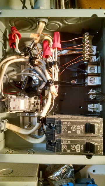

Picture of the AC side power diversion system.

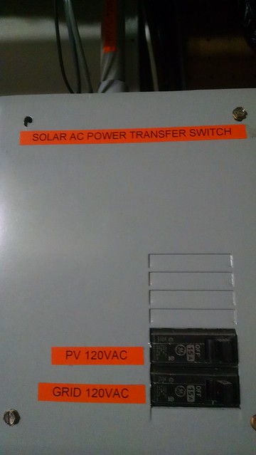

Transformer isolated (from the inverter) transfer switch for diversion loads that switches (not a grid-tie) from 120VAC power sources with a simple relay controlled by the system monitor.

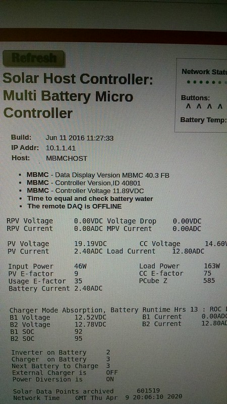

System Web interface.

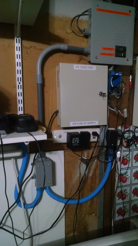

Diversion load power distribution to various loads like equipment battery chargers, shop heaters, fans, lights, etc...

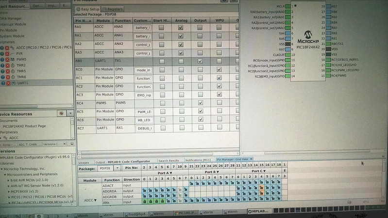

The needed circuit design for a PWM driver and voltage detect with a $1 controller with maybe $15 of glue parts is trivial and might be actually capable of something useful instead of a dubious, unlikely to function as a stable load dump mainly analog design.
I've already mocked up for S&G a modules needed baseline version using a pic18f24k42 in 30 minutes. A measurement adc channel, a reference adc channel, a voltage programming adc channel for setting trip voltage, a few gpio outputs for status leds etc..., a few gpio inputs for mode control stop/start/hold etc , a debug serial port ... and the magical PWM output to a opto isolator to drive the DC power switcher.
