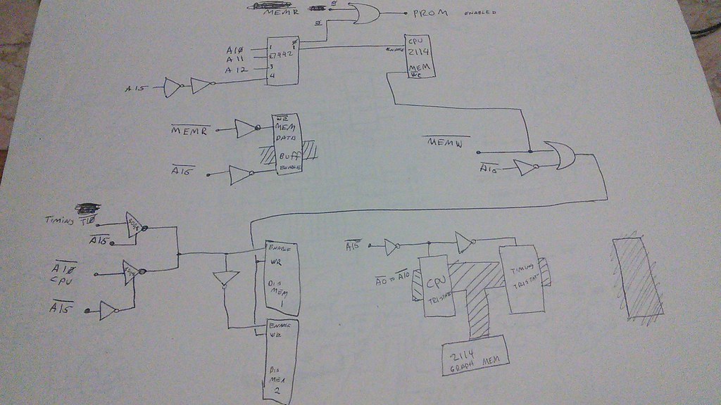

The problem is not static video generation as that's a straight forward design, the problem is BUS sharing with VRAM updates (blanking time or dual port ram) and interfacing to the scan generator circuits as he talks about here. I love his design as he used most of the same techniques from decades ago.
For my mono board I used separate character 2114 RAM and video 2114 RAM to reduce the processing power (8080) needed for a simple character line display while having a separate graphics overlay that used the 8080 to scan transform vector graphic commands. The BUS was shared during blanking and used bank flipping for video page updates.
https://www.princeton.edu/~mae412/HANDOUTS/Datasheets/2114.pdf
