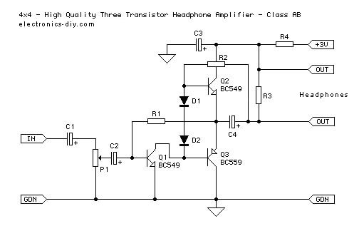

Why don't you show us the circuit you made that produces distortion? Then we can see how much or how little you learned and we can give reasons for the distortion.
You said that you know class-A, class-B and class-AB amplifiers but did not say which one you want.

This is the schematic of the circuit I'm talking about, I just seen it on the internet and try it on a breadboard. It can't power my 5watt 4ohm speaker since it's a schematic for a Headphone Amplifier. Anyway, can you teach me how to edit this schematic so that it can power my speaker? Thanks!

That might be a good place to start but you need to show the component values. Resistor values, cap values, etc.

Do you know how to calculate the power output from an amplifier?
(Vrms squared)/speaker impedance. The amplifier you show uses a +3V supply and output transistors that drive the output capacitor up to about +2.7V with the bootstrapping shown and down to about +0.9V. Then the peak-to-peak voltage swing is 2.7V - 0.9V= 1.8V. The RMS voltage is 1.8V/2.828= 0.64V (almost nothing) then the power in a 4 ohm speaker is (0.64V squared)/ 4 ohms= 0.1W! The power is less as the battery runs down.
The peak output current is (1.8V/2)/4 ohms= 225mA so the transistors shown cannot be used since their maximum allowed current is only 100mA and their datasheet shows that they work poorly below 50mA.
For 5W into 4 ohms you need 4.5V RMS which is a peak-to-peak output swing of 12.7V so the power supply must be about 15V and produce 5W for the output power and about 5W for heating. The 10W at 15V is a power supply current of 667mA.
I simulated your amplifier and corrected it:

R1 - 100K
R2 - 330
R3 - 100
R4 - 22 (2 - 4.5V)
R4 - 100 (5 - 12V)
C1 - 4.7uF
C2 - 4.7uF
C3 - 100 - 1000uF
C4 - 220uF
P1 - 100K
D1, D2 - 1N4148
Q1, Q2 - BC549
Q3 - BC559
Those are the parts list.

If I want to edit your schematic so that it can power my speaker, what values should I change so that it can power my speaker?Since I have a TIP41 and TIP42 in my kit ,Is it possible to change the 2N4401 and 2N4403 on the output side with a TIP41 and TIP42?
