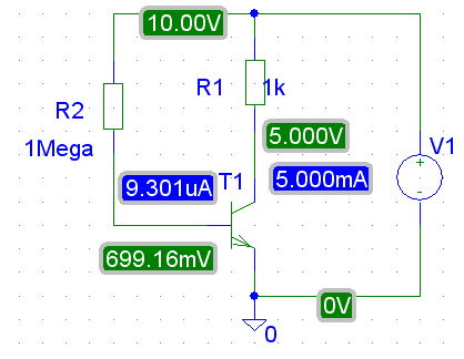

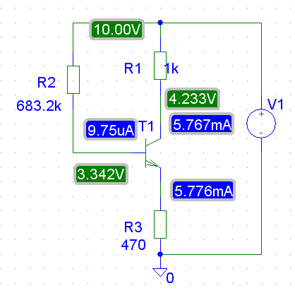

Well, unfortunately this is not true. Re helps a lot.But the VBE voltage still remains: Vth * ln (IC / Is).
So, its DC operating point's dependence on the temperature remained the same.
Ups... yes,you are absolutely right. I forgot about that.Jony130, you have apparently ignored the fact that the impedance looking into the collector is not simply Hoe, but is substantially higher due to the feedback provided by the external emitter resistance. Have a look here for an analysis.
