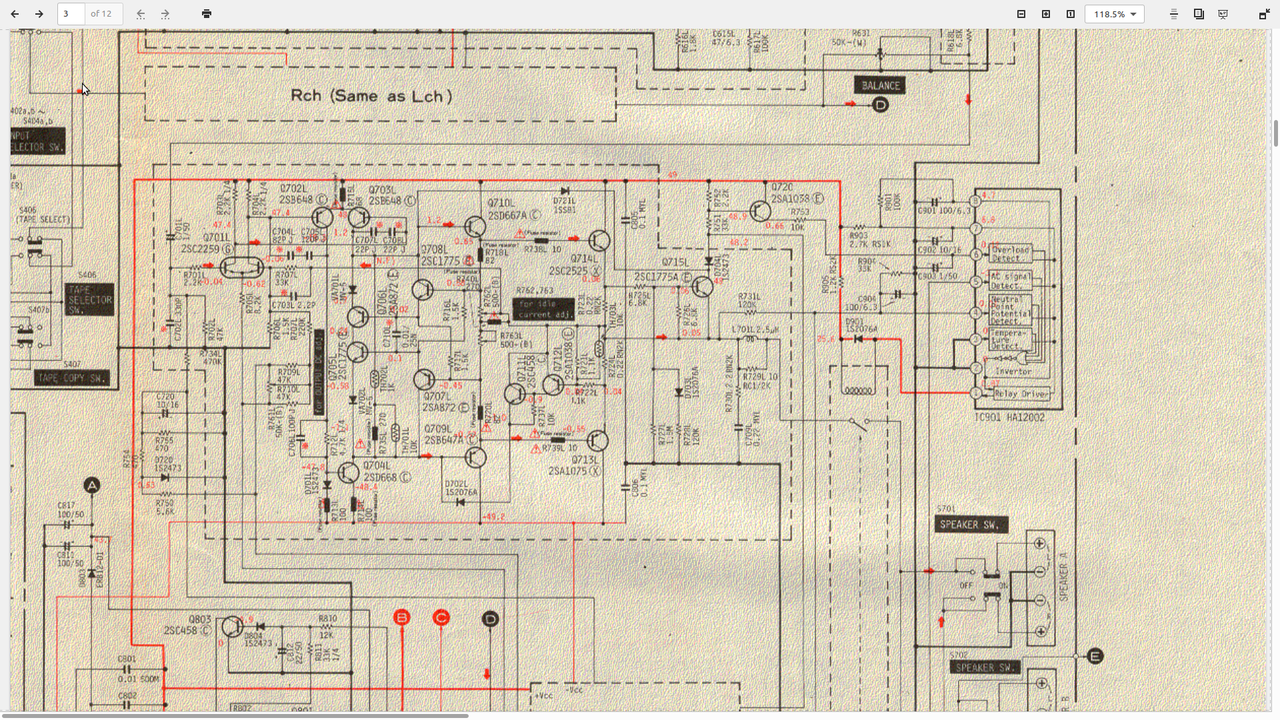

In servicing a 1980 Hitachi HA-4700 int. amp, that does work fine as is, all four of its orig Fujitsu power transistors (pair: Fujitsu 2SA1075 and 2SC2525 ) have hFE of 37 or 60, respectively. These now-vintage Fujitsu devices are no longer in production, and very difficult or $ to obtain new-old-stock. So I don't know how they spec'd in 1980.
I do have some modern substitutes (Sanken 2SC2922/2SA1494) that I will be installing soon. Their hFE are appox 125 to 137.

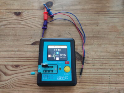

On a side note, how accurate are these cheap ($20) "M-Testers" for measuring hFE?
I have acquired a few of them over the years, and their hFE results (among other metrics) do vary, sometimes by more than 30

Since I'm a lazy sort and don't feel like wading through a huge schematic to find the transistors your are referring to, please take a screen-shot of the transistors and some of the surrounding circuitry, and then post that here.
P. 3 in Serv Manl. Q713/714.
