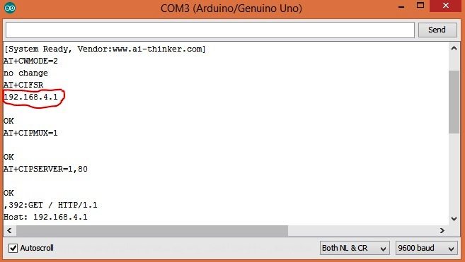

I am expecting to see something like this:
This is the picture I have taken from the website guide, However, I do not get any response when I upload this code and I think I know why. In his code, he is using
esp8266.begin(9600); // Set it according to your esp’s baudrate. Different esp’s have different baud rates.
But my ESP8266 is operating at 115200. So I hace changed that line of code to:
esp8266.begin(115200); // Set it according to your esp’s baudrate. Different esp’s have different baud rates.
And the output I get looks like this :
Maybe I have to reconfigure my ESP8266 to operate at same baud rate (9600) ?

After the code has been uploaded to Arduino , the serial monitor looks like that:
The program was supposed to show the IP adress of the ESP, but it clearly didint. As suggested in the same website, I have used IP network scanner software but I do not seem to recognise any IP relevant IP adress that would belong to ESP:
I do not know how to test/troubleshoot anymore. The only thing I can think of is to find a way to flish a newest AT firmware to it but again - my previous attempts flashing a new firmware ended up with 2 bricked ESP8266 chips.
Again guys, thank you for all your patience and help I really appreciate. Would you be able to suggest me some further troubleshooting?
