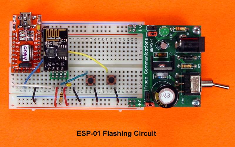

So you downloaded one of these
And you hooked it up like this
A yes or no to both would be a good start.

I have double checked all my connections and realised that once I touch or move some of my jumper cables, the arduino TX led slows down and stops outputting question marks - so It was probably becuase some bad connection on the breadboard. Okay so I fixed that problem and made sure all the wires are tight and properly connected, but every now and then I get some strange symbol or error when I type AT command:
and there have been bad power supplies and the same or similar terminal programs posted at least 5 times. [I think back in #55 that I posted the terminal program with baud rates of 115200 for both software serial and the serial monitor]. You seem to now be focused on changing the ESP baud rate to 9600.The TX arduino LED keeps flashing very fsat and outputting question marks and some garbage as well:

Nothing is connected at j53! I cannot imagine what you are looking at. It’s not the picture you posted.These 2 resistors are connected togethrt at j53. May look deceiving in the picture. Im connecting 2 1k resistors to make potential divider for my arduino TX line
Yes you are right.This is a very messy build with long lengths of leads all over the place and that alone could be your problem....but to this one point...
So, whereas your schematic shows two resistors in the divider, you actually have three resistors in the divider.
First, I suggest that you post accurate schematics so old people like myself don't hemorrhage trying to understand what you are doing and why. But, we have been through that before.Yes you are right.
I think it is as clean and good as it can get by using jumper wires. I do not imagine how could I make it better? Would you suggest?
