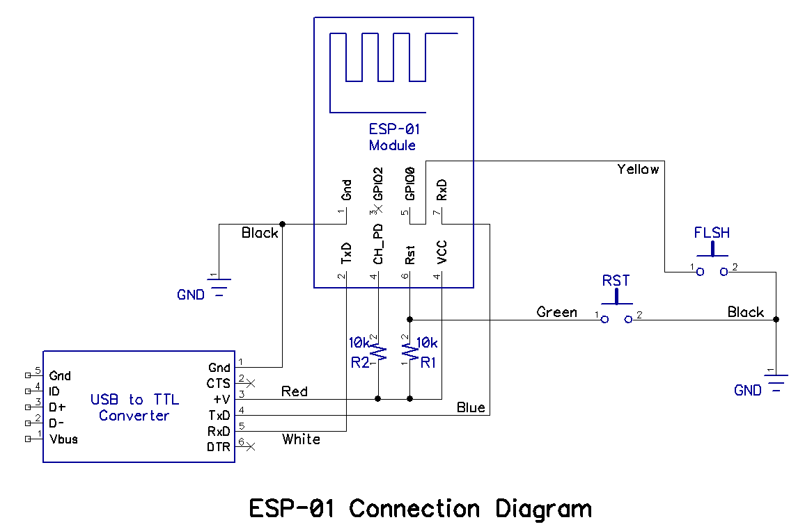

I was able to flash my ESP8266-01 with nodemcu firmware so atleast I know my chip is working. I have been trying to get some AT command answer from my ESP8266 but whatever I do it is not responding.
I have uploaded this program to arduino:
Arduino ESP
RX - TX
TX - VOLTAGE REGULATOR - RX

have done it thourgh nodemcu flasher software. It did work but yet no AT command answers. perhaps my esp8266 is broken? i have been pressing the reset and uploading sketches over and over again and now the red light of ESP8266 is permamently ON. I am not able to flash it or restart it. What are the requirements of talking to ESP8266 with AT commands? Is it not recommended to do with ARDUINO? When i send a command to arduino serial monitor, the command just dissapears after pressing enter button. I cannot even see what i have typed on the serial monitor screen.
You need to have flashed the ESP with the AT command firmware.
You may have flashed the firmware to use LUA programming.
Why not go to one of the links that I posted (or a zillion other ones), start over and make sure you have an appropriate power supply.

I have received my new ESP8266 devices. Before I did anything to them , I have tested some AT commands to them and I did not get response OK from command AT as expected. I did get some random text though. Then I have decided to use this tutorial:
https://cityos.io/tutorial/2010/How-to-put-AT-firmware-ON-ESP8266
I was able to put some firmwave on my ESP8266
After I have put this firmware, I do not get any response to AT commands whatsoever! It doest respond at all.. Any advice?

Hey. Can someone suggest an article or a website that shows how to upload an AT firmware to my ESP8266-01? Its been over a month now since I have started trying to upload an AT firmware but nothiing seems to work. I have manage to break one chip already . I have recently followed this guy - https://www.allaboutcircuits.com/projects/flashing-the-ESP-01-firmware-to-SDK-v2.0.0-is-easier-now/ -didint work
I have flashed a firmware using ESP flash download tool:
Still no AT command response
Can you please tell us exactly how you have the ESP connected...in detail.
What is the power supply connected to the ESP - voltage and amps?
What pin on the Arduino connects to the TX on the ESP?
What pin on the Arduino connects to the RX on the ESP?
How is the chpd on the ESP connected.
edit: How is rst on ESP connected.
What baud rate are you using?
That random text might very well have meant that it was working but yo did not have the baud rate set correctly. There is a bit of text when the ESP boots that is normally seen, but if you were getting text back when sending AT commands, it may have been that the serial monitor on the Arduino was not set up correctly.

this is how I tried initialy, after that, I have connected a seperate 3.3V 1A supply to power my ESP. I have tried different baud rates and at 115200 I got a message ERROR after I put any command. I dont have a clue what firmware I have just flashed but it does not respond at all now. It was said in the description that it is AT firmware
You are starting another thread for the same problem and that is not such a good idea.
You say here that you used one tutorial, which was linked, but in your first thread, you said that you used a different tutorial.
Thanks @bertus
@zazas321
I get it that you are frustrated, but when you are doing a bunch of things on your side and you are not being clear, it does not help you at all. I have flashed various ESP chips many times and so have many people on this board. DETAILS are very important. If we were both sitting on a workbench, we could probably get this up and running in no time, but we are not so you need to help us help you.
So, when you say that you used the tutorial here https://www.allaboutcircuits.com/projects/flashing-the-ESP-01-firmware-to-SDK-v2.0.0-is-easier-now/
But show a screen shot where you are using an earlier version of the flash tool, and then also say that you used another tutorial https://cityos.io/tutorial/2010/How-to-put-AT-firmware-ON-ESP8266 it becomes unclear exactly what you have done and what you are doing.

I have received 2 ESP8266 chips. I have tested first chip like 30 minutes ago with putty, termite and arduino terminal. It did not seem to work so I have tried to flash a firmware that I have mentioned above. So now it got even worse. Okay nevermind, i grabbed another ESP8266 and did exactly same things that I have done with the first one. I have opened a termite, selected my COM port and typed AT - its working! I get an answer OK.
I have tested both, with seperate +3.3V supply and without - both ways are working
Ok great news!
I took my old esp8266 and tried with exactly same circuit to double check whether it is working or not - No response
Then I took that working ESP8266 again, the one that was working 1 minute ago, I open serial monitor again , type AT - no response. I disconnected the VCC pin of esp, connected it back again and now it is working again
