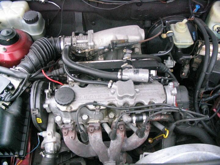

Hi shortbus
Thank you for the link, I've tried the link with different IPs and different browsers but i can't open it, i've attached what i got.
About jumping of the timing belt, no it's not the issue because i've checked the timing belt too. But i forgot to mention it. i guess it has been about five months that i'm checking different things, so it's definitely possible that i forget the things that i've done.
About ecu i guess the car ecu is a motronic 1.5 because as it has been mentioned in the wiki page and the datasheet of motronic 4.1 at the bottom of the page, it has been used from 1987 to 1990 but the car is for 1994, so.
About the temp sensor, no i just checked this one and i don't know where the other one is located. But i'm on it to find the second sensor.
This is the engine
I really appreciate your help and concern shortbus.
