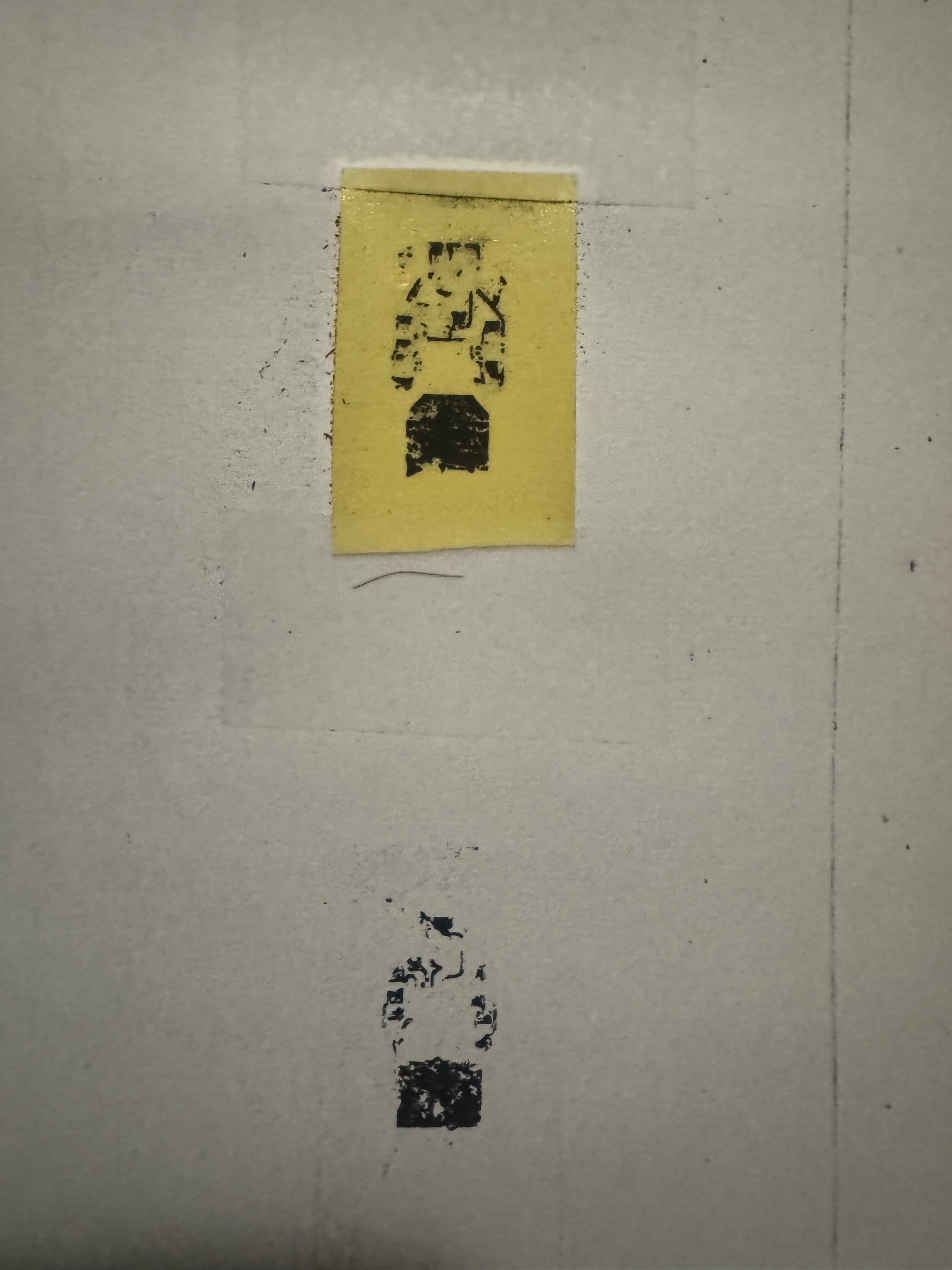

So I ran into some issues trying to make the DIY flex PCB for my integrated half bridge IC chip. This chip has extremely fine 0.4mm pin spacing so the PCB has to be insanely accurate. My previous discrete components BLDC motor controller variant enabled me to create much more crude and less dialed in flex PCBs and things still worked. But with this flex PCB it has to be very dialed in and with very high execution precision. This is no joke. The first issue is that my laser printer does...

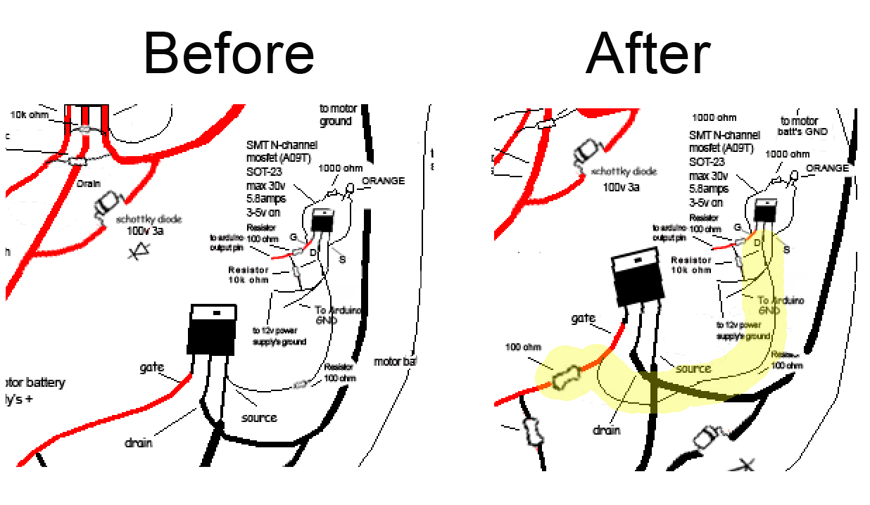

OK, so when I was thinking of using both my discrete components motor controller design parts I already made and then also separately implementing the integrated half bridge IC design going forward, it hit me that the 8v- and arduino gnd tie together on the half bridge IC by necessity but this ruined their intended isolation I needed for my discrete components motor controller design particularly for the lowside switching portion of that schematic. On the lowside switching portion, the...
