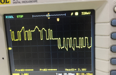

I'm finding some good success fine tuning and debugging my code for processing the incoming commands for my ESC firmware. I added cout<< statements all over the place to report what is going on step by step so I can walk though the code slowly and make sure its all working in the console. There have been some minor tweaks here and there but the code has been pretty solid overall from the first writeup. I think I'm about half way through the debugging process. I am able to feed into the code...
So I realized embedded development is a whole field in itself. I had been listening to the embedded podcast for years and didn't realize until deep into my embedded programming project that I was entering that whole field unknowingly. They speak of oscilloscopes, debuggers, and all kinds of stuff. I don't have any of that. My goal is to simply code the software for my electronic speed controller microcontroller unit in Dev C++ and have it say things like - cout << "hello world"; ---- as test...

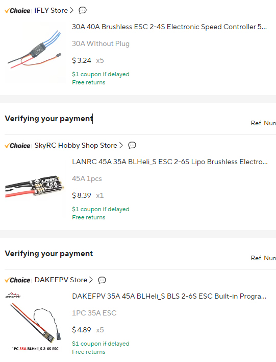

It occurred to me I might be able to find more cheap ESCs in this size profile on aliexpress and I did find some offers that were far cheaper than amazon. The ones I bought on Amazon were'n't too bad on price but these were a lot cheaper but take longer to ship from China on aliexpress. Here was my haul of 11 more: Also pay special attention to the first ESC in that list. It is for $3.25 each SHIPPED and that is CHEAPER than the cost in parts to make my own motor controller from parts...

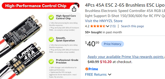

Ok so I had someone point out a very very small very very high amp ESC to me that actually would be viable from a space taken standpoint, however, it was $48 shipped which is WAY too expensive when I can make my own motor controller for $4 in parts. However, I did a search for that ESC on amazon and a very similar ESC popped up that was around same size but made in china with no US middleman and cheap amazon prime shipping which dropped the price to around $11 shipped per ESC. Now THAT is...

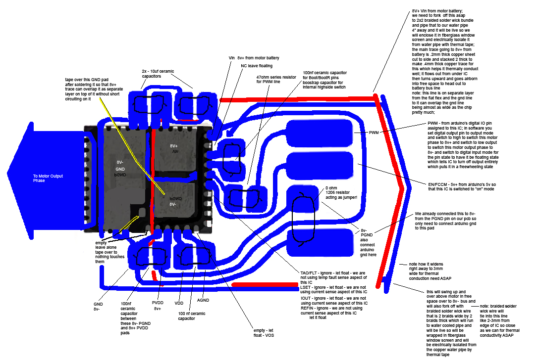

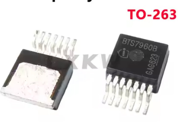

Ok I made my circuit design for my BTS7960 integrated half bridge IC chips. I plan to go with through hole passive components (resistors, capacitors) and use deadbug style so I can skip making a PCB this way. This will cut out that significant step and save time IMO. If I have trouble or determine later a PCB would make things go faster I can design and make one but I am happy to have a break from that for the time being and just go with deadbug again. I like deadbug method alot and think it...

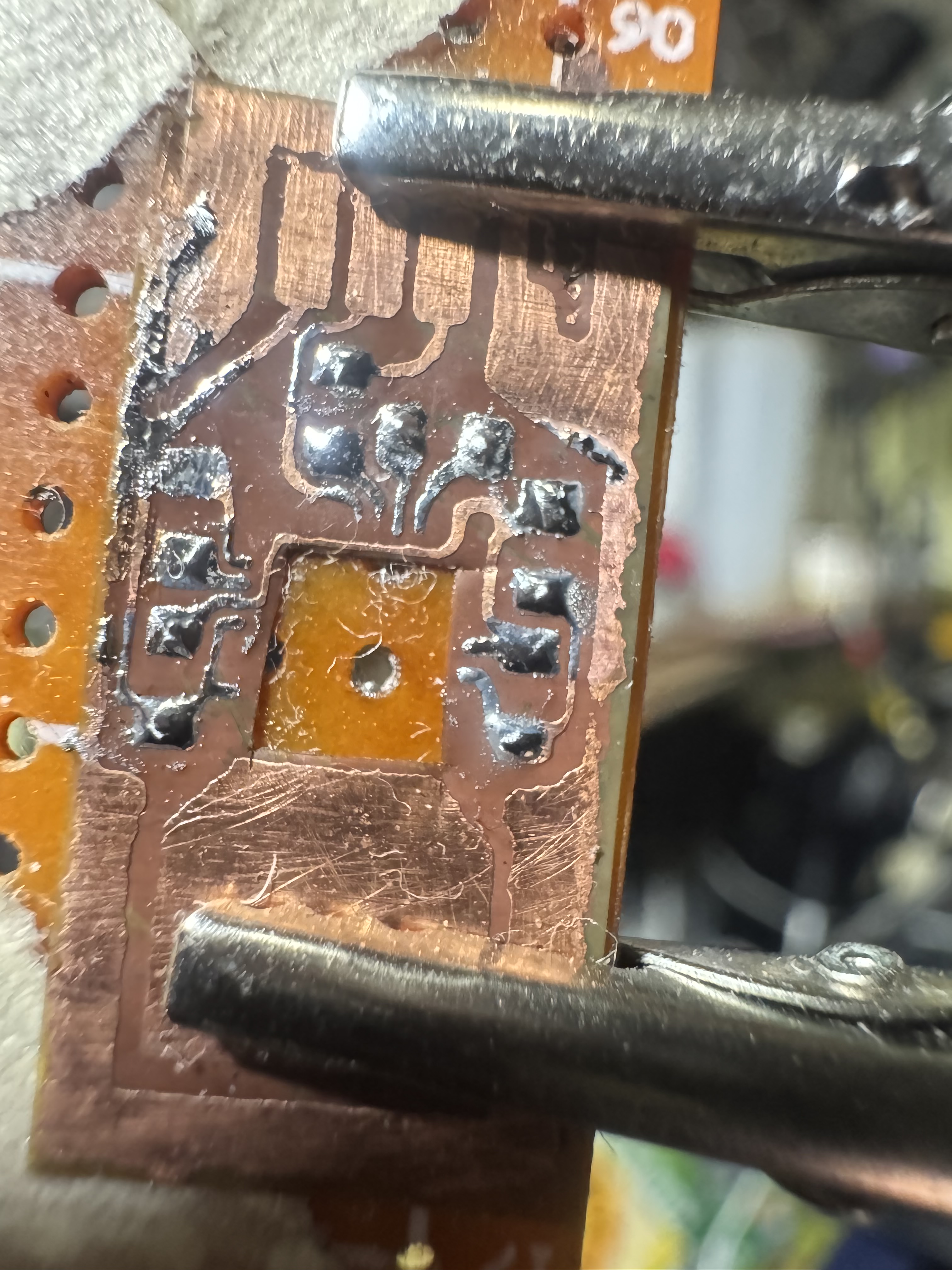

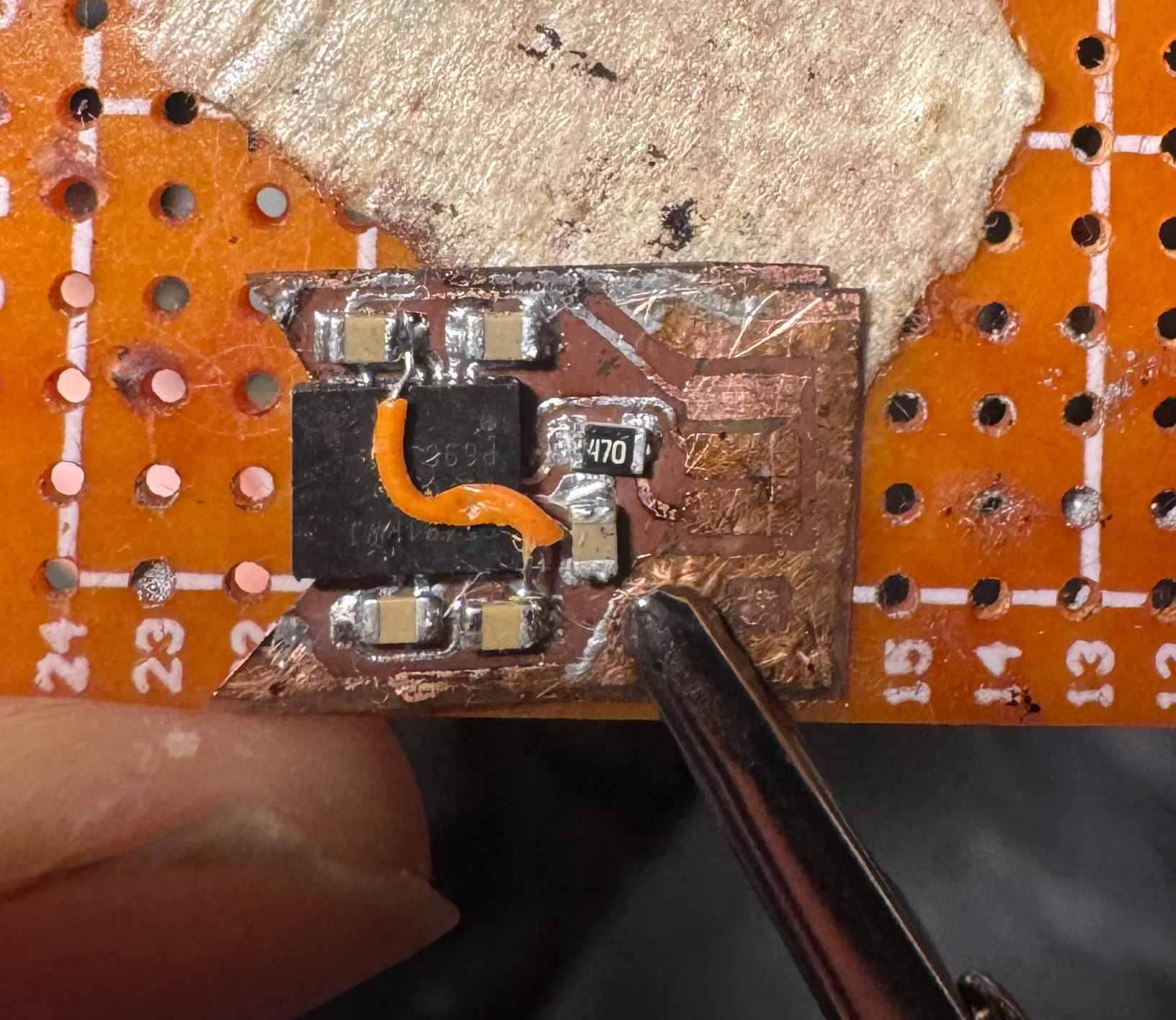

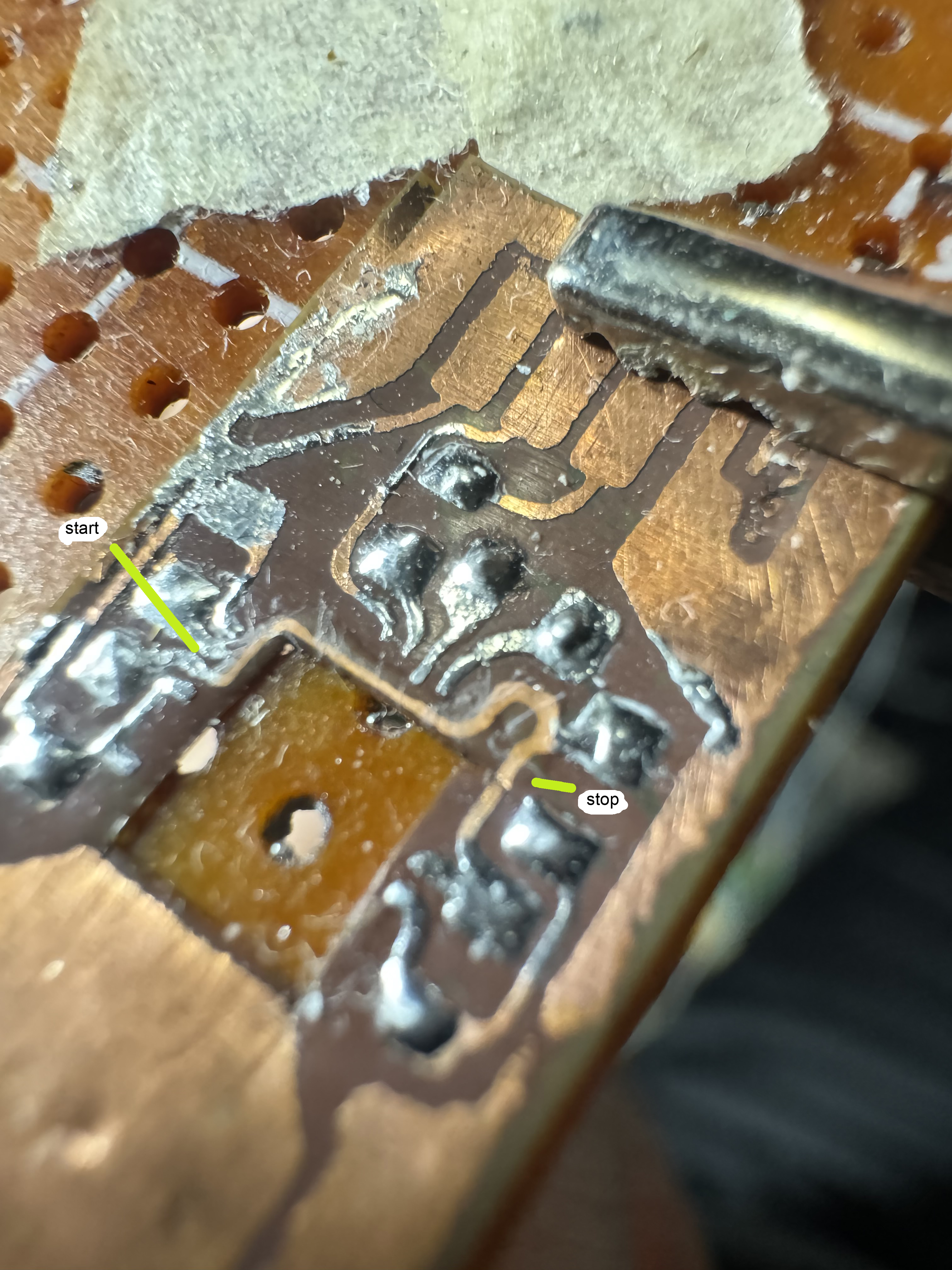

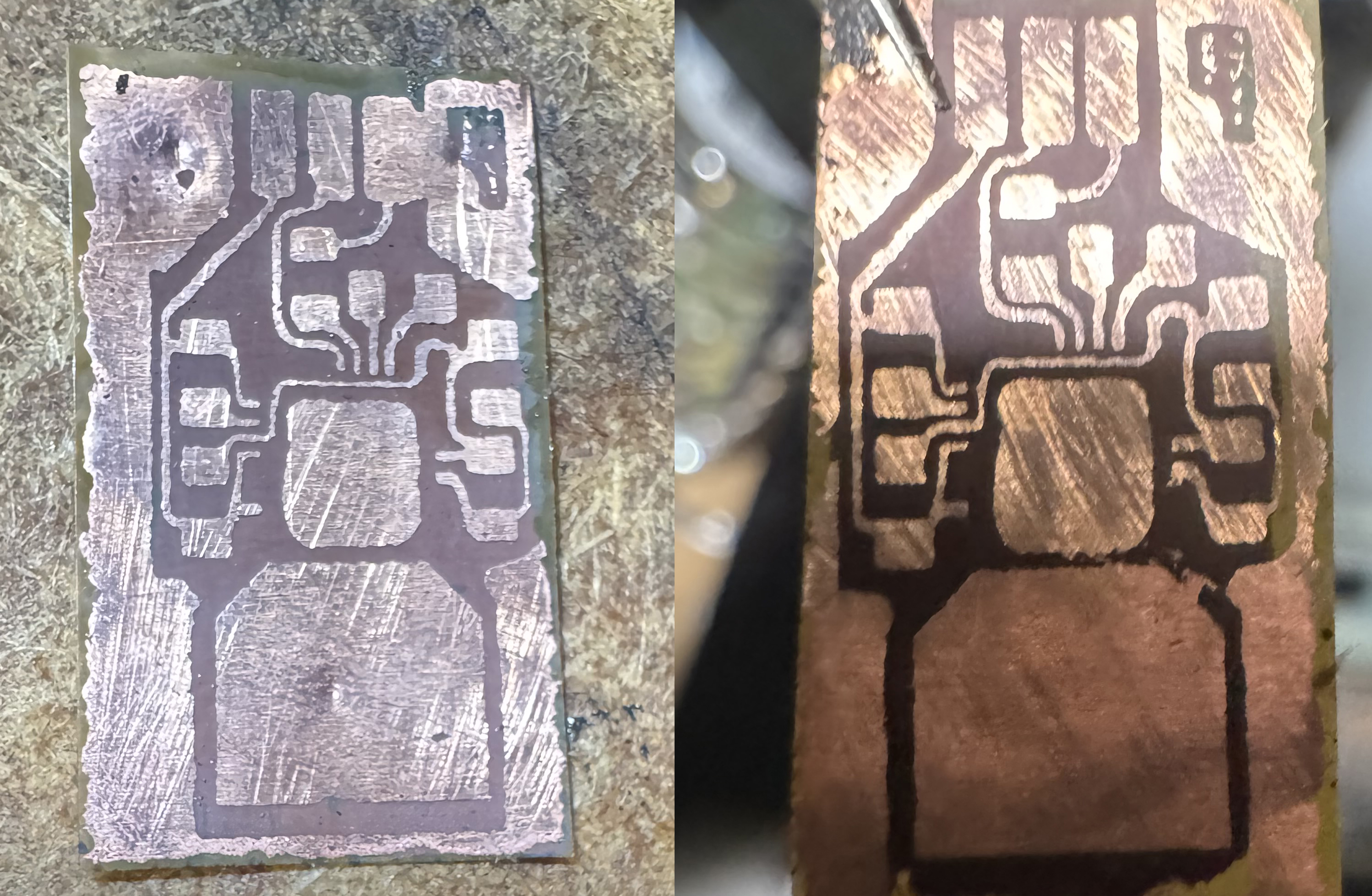

Ok so I ran the test of my PCB and try as I might the PCB was dead. Totally non-functioning. And to make matters worse, I would not have any clue of where the issue is. Could a static electric discharged have bricked the IC? Could some pad have a microscopic open circuit in its joint with the IC? Could there be a hidden short or open circuit somewhere that happened at some point? I simply have no way to know or test or find this issue. And this got me to thinking... maybe a bit bigger...

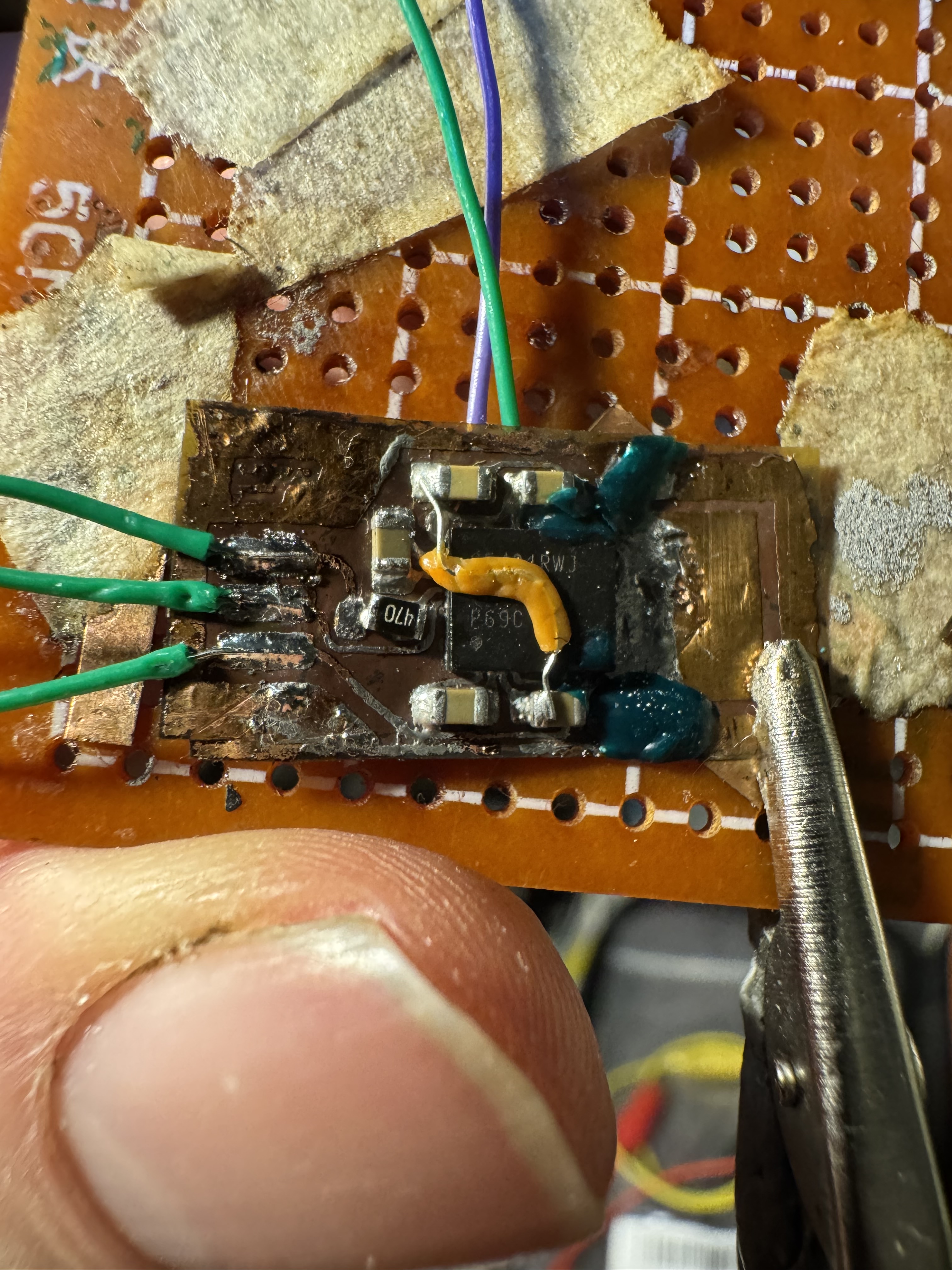

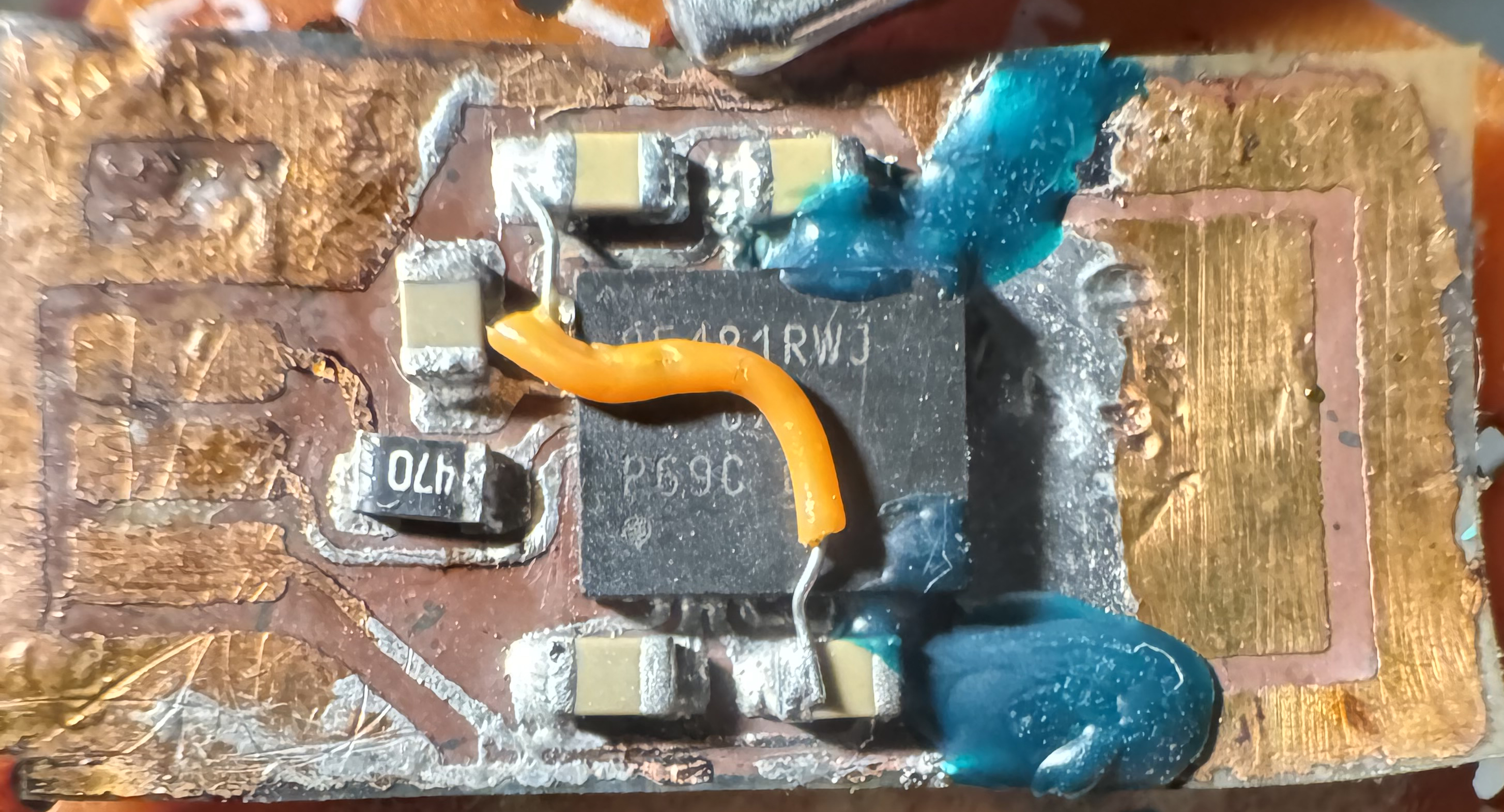

I soldered on 30ga wrapping wire for testing the PCB. The 3 on the front are 5v+ from microcontroller that tells this IC to be in "on" mode, ground from microcontroller, and PWM from microcontroller. The 2 on the back side are +8v and 0v/gnd from the batteries. This was shockingly quite hard to attach these. It's all so dang tiny. Every time I soldered on 8v+, the 0v would fall off because the rear pads of the chip both get hot together. Ended up having to use uv cure solder mask to tack...
