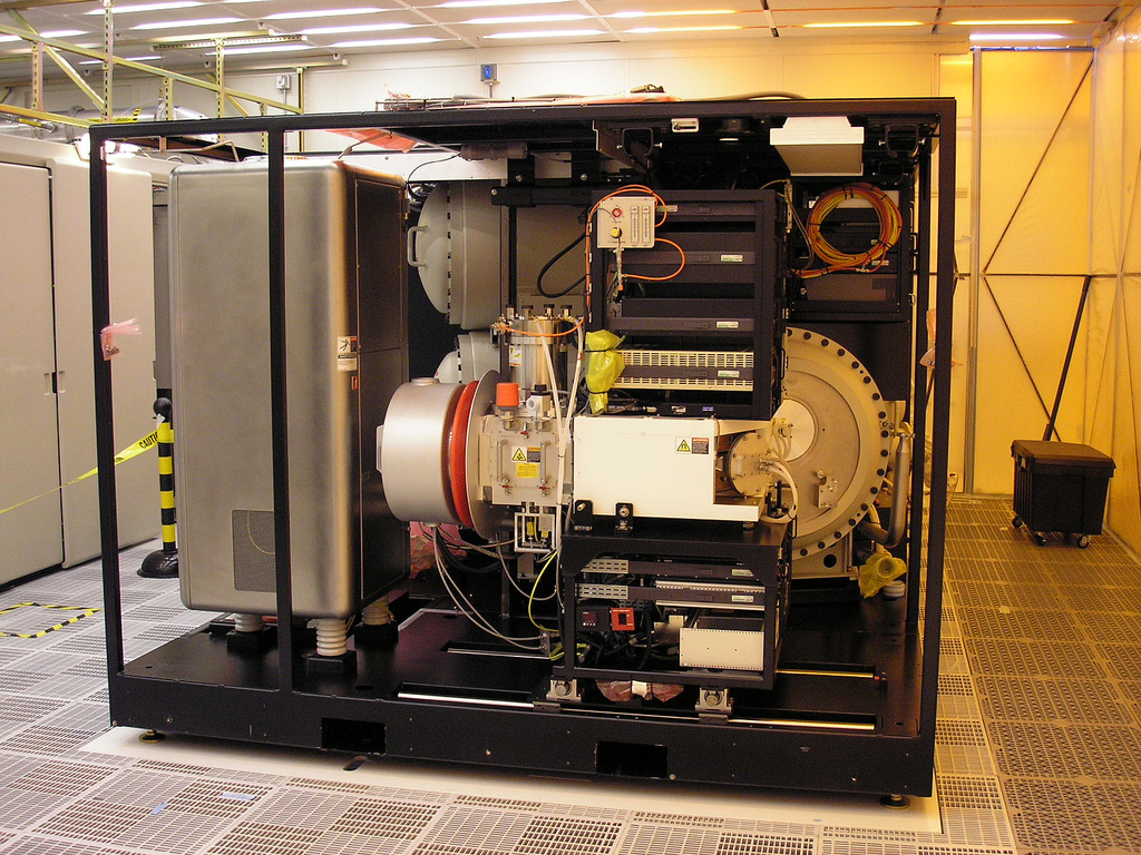

There are degrees of nasty. We had a system that generated p+ ions, kicked them up to about 40kev into a magnesium vapor cell charge exchanger for p- ions into a 1.5 Mev Tandtron. A large turbo is installed on the top , when that thing blows you have a Phosphorus Magnesium toxic fire that's almost impossible extinguish unless you have a special Class D. Had it happen a few times but I'm not on the HAZMAT team so I could watch it burn while they put it out.
Similar system:
