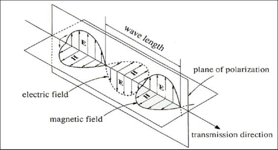

Wave equation:
http://tutorial.math.lamar.edu/Classes/DE/TheWaveEquation.aspx
Or simpler:
But in the case of light, the two vectors are like that:
http://www.mike-willis.com/Tutorial/PF3.htm
One is perpendicular to the other.
We could represent this mathematical using the imaginary number and as the complex impedance in electronics.
I tried to "dress up" the conversation in a form to attract you, and I neglected a little the rigor.

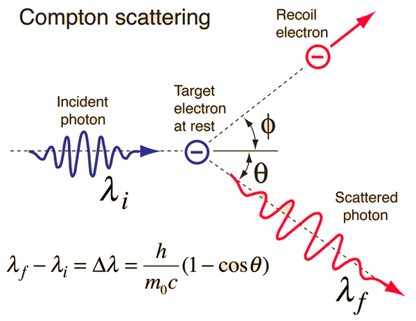

I would like to write here about the Compton effect:
A photon "hits" a free electron. What happens?
Incidental radiation decreases its frequency and the photon acquires kinetic energy.
Is not it weird?
