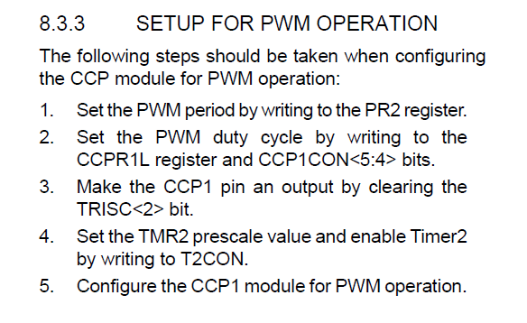

Here is the steps that i have followed
BUT while simulating it in proteus i did not get any result from RC2 PIN(CCP1 pin of PC microcontroller) i did not get any pulse from the pin.
What is the problem??
sagor
Joined Mar 10, 2019
1,055
You are not setting a value in CCPR1L nor CCPCON1 <5:4> for duty cycle. So, with a 0% duty cycle (no bits set), your PWM cannot output anything.
PWM Duty Cycle =(CCPR1L:CCP1CON<5:4>) * TOSC * (TMR2 Prescale Value)
What speed is the PIC running at? That determines the PR2 values and others... The 16F87xA datasheet I have shows example for 20Mhz, with totally different values than yours. A simple PWM calculator shows: (PR2 = 101 decimal which is 0x65)

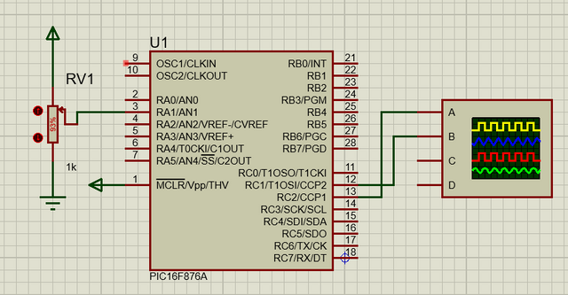

khatus
Joined Jul 2, 2018
115
Here is my code This time i wanted to vary pwm signal according to a potentiometer connected in pin A1.Here is my code for mikroc.But THe pwm signal did not vary according to the adc value.

https://openlabpro.com/guide/pulse-...nlGO5xAImaFrZUSOzNqZa5DS4t4Hts6kWZaBuF_nyQBIg
I used the following link code for my code.
