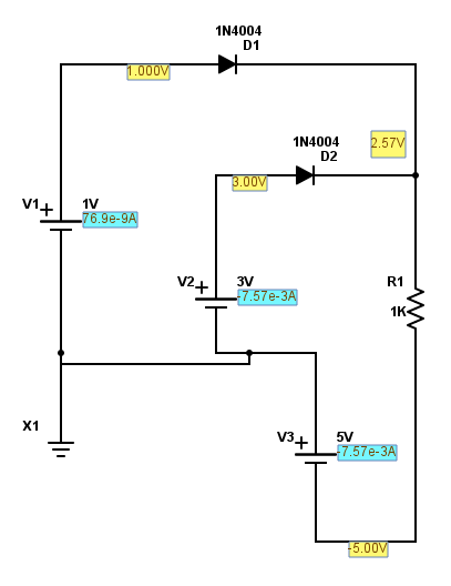

I got two circuits. One from a textbook example and one that I made and simulated in "PartSim".
I don't think they are supposed to be the same. I'm suposed to give an answer to the question: "Are the voltage out from the diods different? And if they are, why is that."
In my case they seem to be different.
The voltage out from the diods in the textbook example is: Vout = 3V
The voltage out from the diods in the circuit that I made in "Partsim" seems to be = 2.57V
So what's the explanation for the difference in voltage out from the diods in these two cases? :)
Circuit from textbook: (Vout = 3V)
Circuit made and simulated in "Partsim": (Vout = 2.57V)

The textbook answer is clearly using an ideal diode that has 0 V drop across it when forward conducting.
The simulator is using a more realistic diode model that has about 0.43 V dropped when conducting about 7.6 mA.
If you play with the value of the resistor you will be able to plot out the voltage drop for various currents and will likely find that it is largely exponential.

It's not uncommon for a textbook to introduce the concept of a diode as an ideal diode and have a few problems like this to get the basic notion across and then move onto the exponential model and then back it down to the piece-wise linear model that is used for nearly everything after that point. That's usually all covered in the first half of a lesson.
If you play with the value of the resistor you will be able to plot out the voltage drop for various currents and will likely find that it is largely logarithmic (since the current is nominally an exponential function of the voltage).
