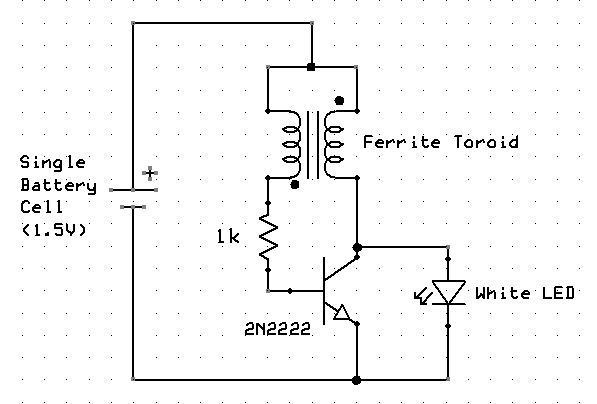

How feasible is it to use a circuit based on the following?
(Source: http://technologytutor.co.nz/technology-and-science-for-kids/01-build-your-own-joule-thief )
Obviously changing the battery to a 9v, changing the resistor , and chaining a wings worth of leds rather than the single ( with a resistor at the beginning )?
In addition, wouldn't having a differing number of windings for the inductors effect this? Say having twice the number of windings on the 'resistor' side ?

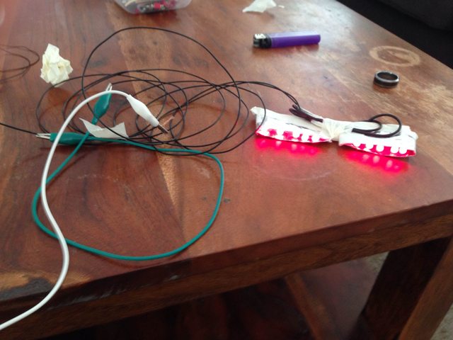

I thought I'd show off a little if thats ok...
Firstly here are the lights for the mask...
not attached to a mask as yet. I've a few prototypes, but I've not found a mask design I want....

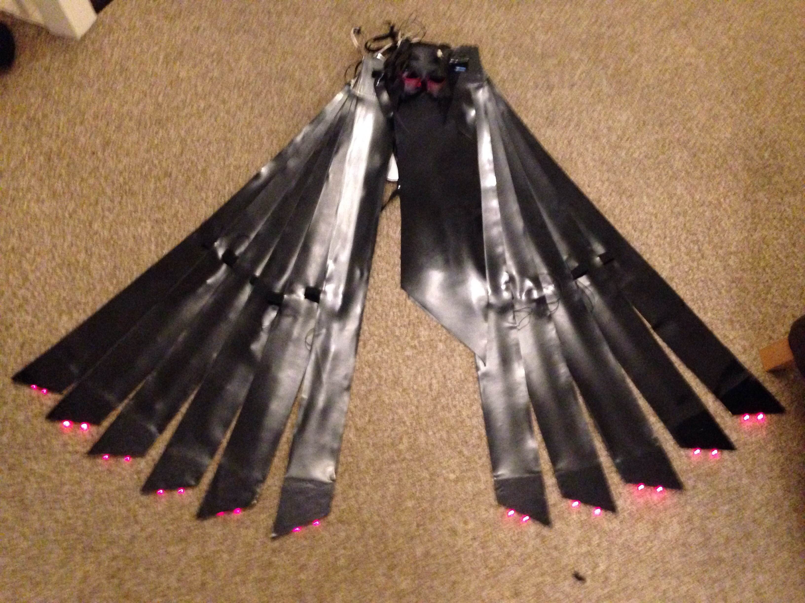

wings...

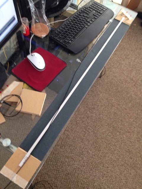

This is the inside of one of the wing 'blades', I can't really finish it off until I have all the other blades ready and I'm waiting for delivery of the metal 'bones'. What I can do however is begin wiring up the LED's as all the 'head' plates, I've enough components to wire up one wing .

So in the end, having all the lights in parallel, did cause one set of wings to be slightly brighter than the others, I suspect this was caued by a change in gauge of the wires ( I ran out near the end and had to use one length of thicker wire to complete the circuit). my biggest fail wasn't electronic, but the use of elastic governing the available 'spread' of the wings. I'm currently trying to think of a 'hack' to fix that.
In the end I used 4xAA batteries ( 2 parallel sets of 2 in series )... worked a treat. Perhaps I could've added more, but I didn't want to risk blowing them.
