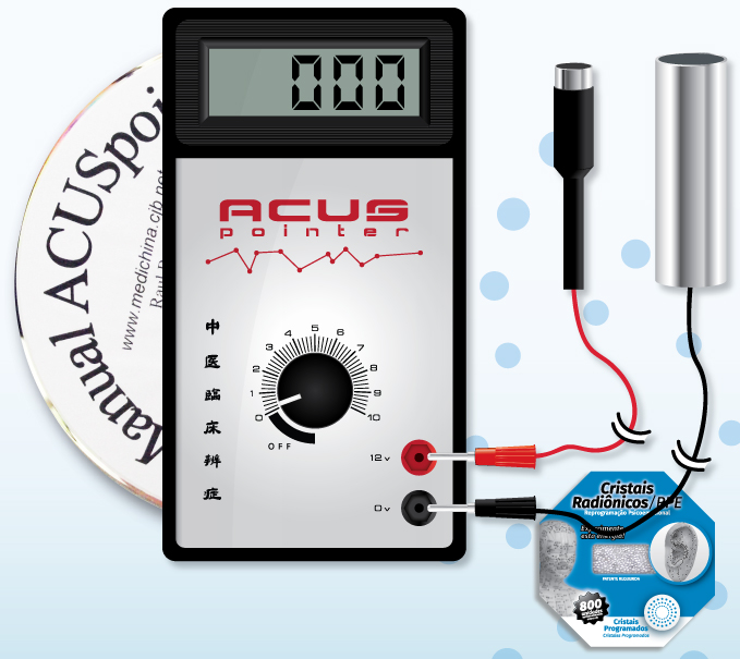

Thanks a lot everyone!
. Is the readout a digital display, or an analog meter?
The acuspointer is digital, the ryodoraku is plotted in a graph, in a computer, via USB.
If you're unable to open one, would it be possible for you to at least post a picture of one of those devices?
Sure! Here's the acuspoint:
And here is Ryodoraku
Please, does a regular multimeter measures the skin impedance? Or does the multimeter should have a special sensibility? Or is there a specific instrument for it (if I want to play around to see if really my skin impedance would chance if I was sad or happy... what instrument should I buy?)
Thanks once again! =)

Actually, them ARE just glorified multimeter. BUT, the real science lays bit deeper.
Firstly, the simple resistance measurement of skin can give You an idea of WHERE to stick the electrodes for accupuncture.
Secondly, very rapid the electrode polarization takes the place, thus the metal name have meaning for electrodes, the best one is platinum but may forget it, and next best are gold. However gold-plated are importantly weaker, mostly are used them. But it is not enough wit the right metal. Next is algorithm of electricity let few milisec it flows from one electrode to next, and then the same time backward. Most of biosystems use frequencies just around 10-100 Hz.
Third, if You modulate those low frequency with a hardly higher, between kHz to GHz, You get readable the imaginary part of impedance and real part, thus the resistive component may be calculated out. That is far better product, as the frequency gives a message about which depth we speak, from intra-membrane measurements or just outside the cells fluids like it happens at mastitometer devices for milk cows (Draminsky, MA-1, etc etc) - as known at mastitis explodes the cell membranes thus the K and Ca rich intracellular fluids get mixed with extracellular extracellular fluids rich by NaCl, and this is sensed by mastitometer.
Fourth, if to go more deeper layers of unknown, I advice to read the software RISE frequency tables what allows (by their authors mind) to measure and even to get healed practically all known illnesses, from cancer to just depression, from alcoholism to heart failure.... This method this year was nominated be included into anti-science dictionary, however I KNOW that effect of quazi-resonances exists (even some my publications are based on that effect quantification). I may wonder if those frequency tables has not `sucked-off the finger`, but I am sure there indeed exists a multiple local resonances and their well systematized research aren`t done by none nowhere. And they are human to human different.
One of relatively cheap solutions is Chinese pH tester for few USD at ebay, I bought it (EZ-1) few weeks ago and am quite happy (for to measure the destillated water quality). If I try it on my fingers skin, I get readable result, thus I will to hope that it uses a AC antipolarization system like I show above.
One more problem is the skin wetness impact, what may create the 1000-fold impedance difference, thus readings on finger and readings on elbow may be different in without of ANY medical reason. The next factor is acohol, even one tea-spoon of strong alcohol may give a tenfold or more impact on skin resistance, and each person has another dynamics of setting it back, and localization mapping.
However, MOSTLY the system RIFE is just the bucks milking imitation to fool the clientele, for some 25% I believe it is possible in future to design it`s correct medical use, probably. For example, one my friend, the pensioned Dr.Phys is stating he had find the frequencies very well showing the cacncer hiding in body, what are far far different those mentioned at RIFE (as it is officially public licence freeware having no restrictions for spreading, inspite of whaaarn I hot here from moderators in similar situation, I risk to link it here www.dropbox.com/s/oxq0pjailnap6eq/rife.zip?dl=0). Inside You shall find a software generating the RIFE signals as well the frequency tables with linked probable diagnosis.

AnalogKid
Joined Aug 1, 2013
12,254
Yes, any basic multimeter can measure skin resistance. The problem is consistent contact.
1. Measure the resistance from one hand to the other by pinching the tips of the probes with your fingers. Notice that the reading changes a lot when you pinch harder.
2. Lick your fingers so they are damp with saliva and try again. Notice the changes in readings.
3. Use clip leads to attach the probes to small metal objects. Grip the objects and notice the changes in the readings.
There are all kinds of theories about what material should be used for the handholds. Some like pieces of 1" copper pipe wrapped with a paper towel soaked with salt water. Others think this forces copper ions to leech into the skin. Some like stainless steel because it wont corrode; other don't like it because of its chromium content. The same for-and-against arguments apply to most metals.
Without getting anywhere near the question of whether or not the readings mean anything, just getting them reliably is a significant problem.

RE:""Yes, any basic multimeter can measure skin resistance. The problem is consistent contact.""
These readings mentioned are too unstable, and heavily depends on contact PRESSURE, skin WETNESS, and TIME under current (electrode polarization). Those factors MUST be corrected.
Janis59
Joined Aug 21, 2017
1,893
RE:""They're ohmmeters, to be more precise.""
You are bit too optimistic. The bad medical impedance tester stays 3,5 digits, in average 4 digits, and only in very good devices the 5 digits. Whilst the ordinary 50$ multimeter has at least 4 digits and only 1$ China-made has 3, yet more accurate high-end devices has more than 7...9 (what is absolute overkilling, mostly, as the thermal drift is larger).
