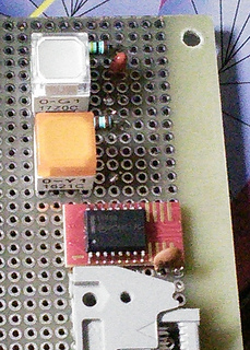

I just used an adapter to mount a SOIC-16 MC14490 chip on a Vectorbord® .
You need to really clamp or solder that little adapter to something solid first before trying to solder the chip to it. :mad:
Try using sticky tack ... I heard it works pretty good on holding chips when soldering...

Years ago, Velleman sold sheets (about 4"x6") that had adapter PCB. The price was reasonable when considered cost/adapter. Last time I looked, the adapters were quite expensive compared to what was going on them. Given the cost/in^2 for cheap, commercial PCB's, one only needs to plan a little ahead and get them cheaper that way.

I've been using surfboards for quite some time. I like them a lot - . I don't particularly care for them standing on end because they move around, but I do like that they have extra pads on the board just about everywhere.
There's another brand that I've been using more of these days - but they have an awful brand name so I always go have to look it up on their silkscreen - and I'm at home right now. Found them! http://www.mouser.com/search/refine.aspx?N=4294759014 - these are nice - you get a lot of them too for $50 or so too. I can have a tssop up and going in about 3 minutes. I also add decoupling right to the board so it's not taking up breadboard space. Using these also helps plan your layout for a nice smooth transition - something I like.
Something I should point out is that many of these small chip can be difficult to use on a breadboard because of they are so fast! Layout is critical!
