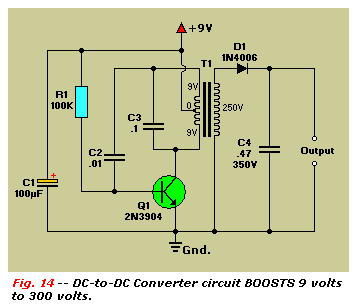

Yes, that's exactly what I am proposing, it's actually very common, and is the theory of most DC-DC converters... to get a high efficiency, or to switch from a lower DC voltage to a higher DC voltage. Typically it's switching a DC signal and putting it though a transformer...
I'm wondering if maybe an "off the shelf" part may be my solution...

If it's any help, here's a link to a thread that I started a few months ago, in which members of this forum helped me design a transformerless voltage booster that went from 12VDC to 75VDC
MachineHum
Joined Nov 3, 2014
74
Oh wow that's really interesting... If i'm not mistaken it's using the characteristic of an inductor to appose change in current, then essentially "forcing" the current over that diode by cutting current flow through that FET... cool thanks for the link, I'll probably do a little more reading on that later...
cmartinez
Joined Jan 17, 2007
8,796
Yes, that's more or less what it's doing... it's actually "pumping" current through the diode (which is preferably of the fast-acting type) and then holding it on the other side through the capacitors. The circuit stabilizes when it reaches 75V, but the interesting thing is that it has to have a minimum load for it to work properly.
