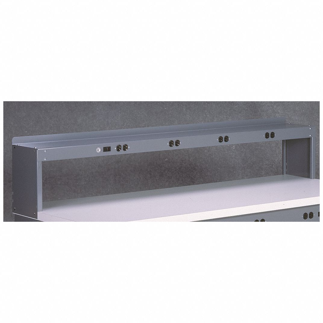

I've added these shelf risers with built-in outlets to my own bench and some electrical outlets to the inside walls. Too bad they only come in 6' and 8' widths. Great to have immediate access to cords of all instruments right in front. Just lift them out - no fishing for cables. I added an extra outlet on left snd right inside walls with conduit. The master switch and pilot light are a great addition. Also has a 15A breaker built in if you buy the electrical kit. Or you can swap out whatever size breaker suits your needs.
