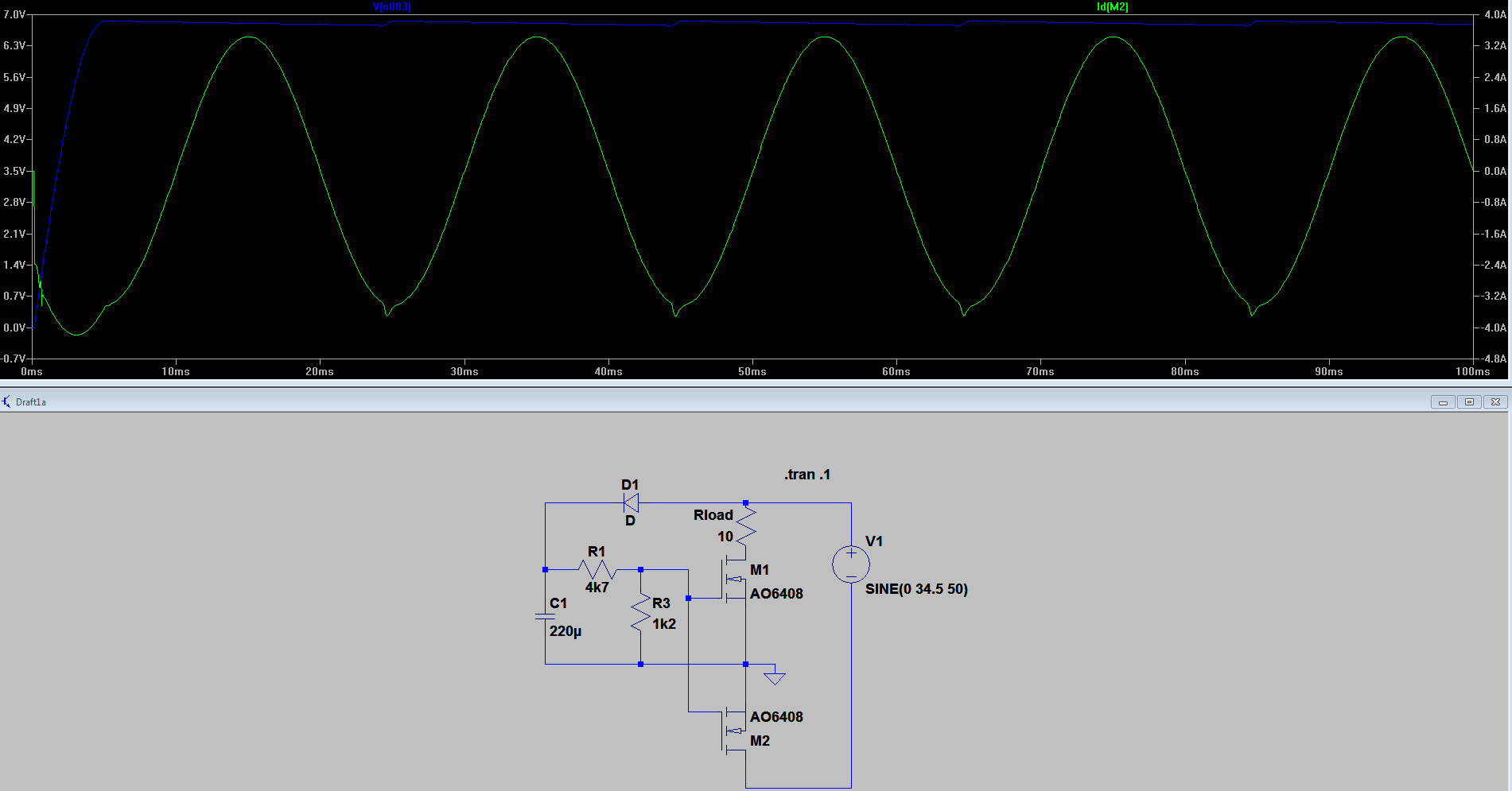

the lamp i am using for testing at the moment is 150w however i intend to go with 300+ .
Alec_t: the problem i had with the VGS voltage stemmed from my assumption that the lower fet, when turned on will conduct the peak 34V from its drain to the source - this then passes through the body diode of the top fet to the load.
I figured that when the lower fet turns on, its source would be equal to the 34V peak value at the drain - but with the flow of current inverted in relation to the opposing cycle, i assumed this to be -34V at the source of the bottom fet and therfore a large VGS value incorporating the positive capacitor value and the negative source value.
Can i pester you for a quick explanation of why this is wrong (not that i question it isnt).
I think it is likely coming from the way i am visualising the voltages and currents, making elementary errors.

The problem is that the AC voltage is floating with respect to the shown circuit ground, so it's difficult to visualize what the AC voltage is relative to the MOSFETs and the MOSFET's ground.
A simulation is the best way to see what's happening. You might give the free program, LTspice from Linear Technology a try. We can send you the .asc simulation files for that if you like.

I have got the simulation up and running in lt spice .
I can indeed see the gate voltage behaviour.
Being obsessive, i was wondering if anyone knew the cause of the peak during the negative portion of M2?
It's the capacitor charging current through the diode at the positive peak of the sine-wave. The path of that current is through the circuit common connection back to V1 through M2.
To find odd currents like that, just start looking at the currents in the other components. That will usually lead you to the source of the anomaly.
That's the handy thing about a simulation. You can easily look at currents and voltages anywhere in the circuit.
