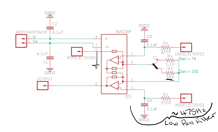

@TeeKay6 @Vinnie90
Afternoon all,
It's been a while hasn't it but I have actually made some progress today. First things first one of the things that undoubtfully screwed with my progress is that the breadboard I was using in the original post has a break in the rails half-way down which meant any part of the power rails I used on the lower half went nowhere. More importantly, I looked into getting an oscilloscope and, £60 later I know have a wave generator and one of those handheld open-source DSO150 oscilloscopes which work wonders for me. I have also come to the conclusion that my multimeter is no longer very accurate after some testing so must endeavour to get another one of those.
On to news of progress being made in the circuit, I think I have finally got a working in-amp design although it still needs some work which I'm hoping you chaps can help with. Here is the design I am using except the gain I have is about 80:
The output I am getting is about 0.9V relaxed and 1V-1.1V when I tense my bicep. The low pass filters cut off is about 475Hz. The reference electrode is on the back of my hand. Is there anything I can do to make the signal that is output a larger range? Ideally, I'd like this to be 0-5V. Also what changes/improvements should I make to this circuit before I move on to the precision rectifier? I have a feeling there's still a fair amount to improve on.
Thanks

@Rossosaurus
Two initial comments:
1. You show GND2 symbols, but nowhere do they connect to anything resembling ground. The INA126 Ref input (pin5) does not establish a ground; it simply sets a reference voltage for the amplifier. At present, GND2 can be at almost any voltage between INA126 pin7 and pin4 voltages.
2. Look at the INA126 datasheet, specifically the section Electrical Characteristics (Section 6.6 in my version of the datasheet) and find the area of the table labeled OUTPUT. Note that the output cannot swing rail-to-rail; it cannot come closer to either + or - power supply voltage than approximately 0.9V. That should ring a bell for your output being "0.9V relaxed". The INA126 is simply in saturation against its "-" power supply rail. The signal might be attempting to swing over a range of 10V, but only the tiny bit from 0.9V to 1.1V can be outputted.
See my next post for UPDATE to the following paragraph:
The INA126 is intended to operate between a + and - power supply voltage of ±1.35V minimum. You seem to be operating between 0V and 5V, with nothing setting a reference between those values. I suggest that you add two resistors (e.g. 470Ω each) from the 0V and +5V power supply inputs. Tie the other ends of the resistors together and tie that to GND2. This will set GND2 reference to +2.5V (relative to the - power supply), i.e. the INA126 will operate with ±2.5V.
The output when "at rest" must not come closer than 1V to either the + or - power supply rail.

@TeeKay6 thanks for the quick reply. Im out of the house now until Sunday so I'll take a look at all the practical stuff then. Just wanted to say about the GND2 problem. The ground I'm using is the one on the Arduino I should've have put an extra input down labeled GND2. As for the reference I was aware of it's purpose however I was unsure whether I also needed to attach it to a ground or not. I was leaning towards not needing too as surely the signal from my arm would follow the path of least resistance which would be towards ground but decided otherwise for some reason.
The Arduino "ground" becomes the "-V" power for the INA126. There is no connection from GND2 to the Arduino ground except as described through an added resistor (and multiple bypass caps). After reviewing the datasheet again, specifically the Section 8.2 Typical Application (also Section 9.1), I have come to the conclusion that the simple voltage divider I advised will not be sufficient to create the "missing" GND2. Instead, the new voltage divider (the 2 added R's) would have to be buffered by an opamp voltage-follower OR (better) replaced by a low voltage regulator (dropping the input 5V to 2.5V output). The INA126 "Ref" input should be connected to the newly created "2.5V" GND2 and to the arm electrode. When not connected, the Ref input could be at any voltage from the Arduino's 0V to its +5V. There is no path of least resistance (at least not a path that can be guaranteed); your body potential floats like any other conductive item.

@TeeKay6
Just a quick one to say that I am using a voltage inverter breakout board so that I can have +5V and -5V from the Arduino. I think the board is an LM2662. I'll do my best to look at the other stuff tomorrow.

@TeeKay6
OK, that should resolve the PS issue. Note that you must also carry the GND from the Arduino to the INA126 circuitry.
